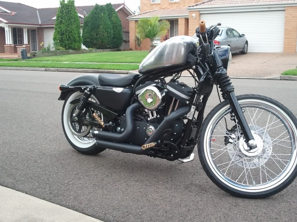

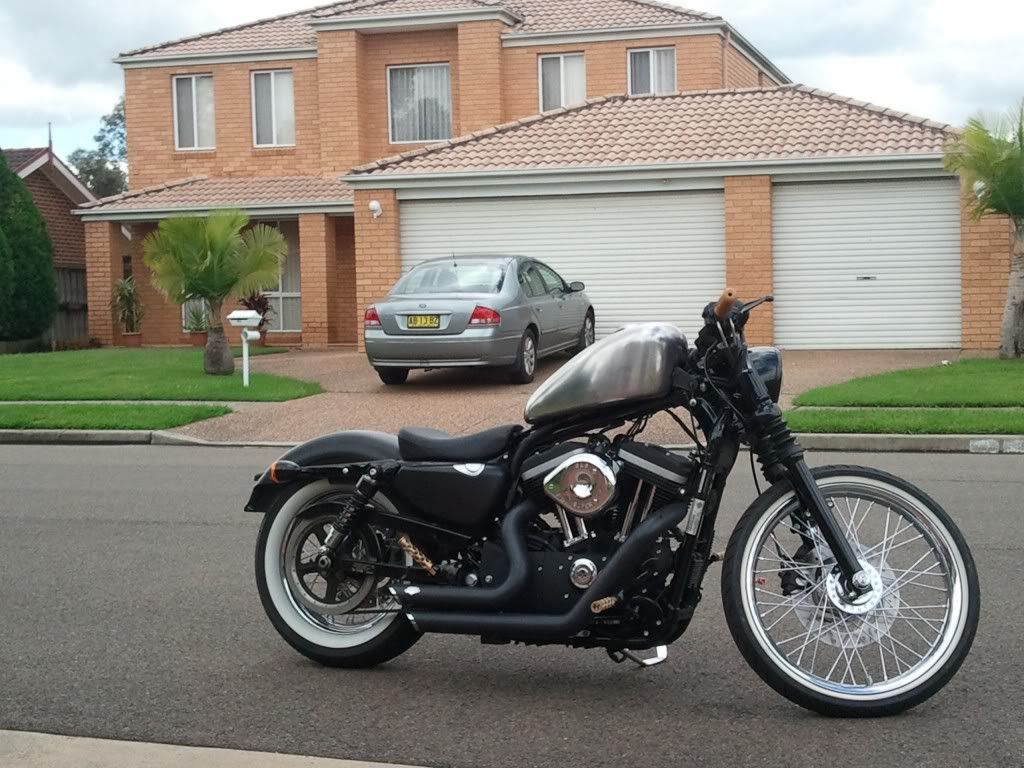

    Hi guys,
    Been promising to post a few better pics of the bike; well I installed the S & S Tear Drop this morning and took her for a strap to make sure I hadn't fucked anything up.........fortunately she started, idled and went like she should!! I'm really happy with the way its progressing, may not be to everyone's liking but really starting to look exactly like I want!
    Anyway here are some upated pics:

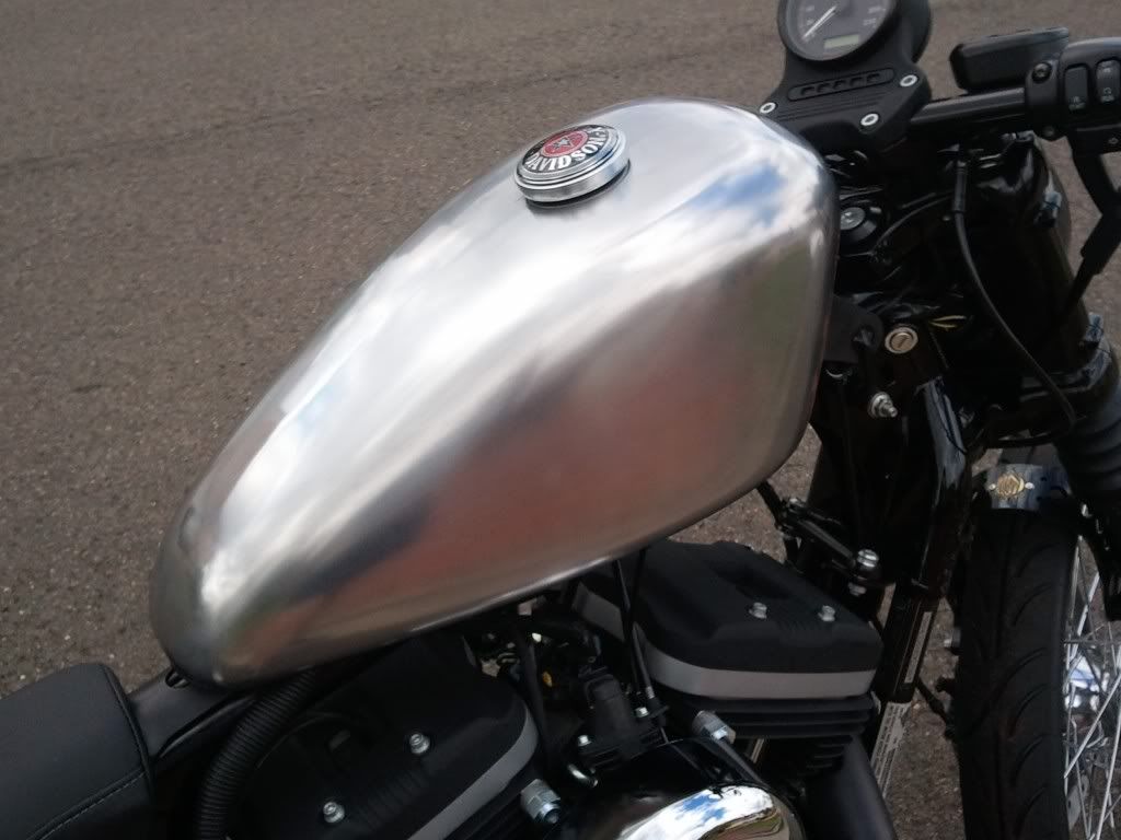

    Looking good mate, i really like the way you have taken this bike. Only thing i see that you might want to consider is rub the air cleaner with scotch bright to dull it out so it looks closer to what the tank is.
    Good work mate!

    Cheers T1, definitely onto something with the air cleaner, just rough it up a little to dull the chrome a little!!

    Hell of a lot of work in there. Looking the goods. Are you going to do the rear fender and oil tank?

    Stripping that tank! awesome.

    Looking real cool. Did you end up clear coating the tank? Really like the look of the Tear Drop cleaner.

    looks good man, you going to keep the S&S chrome? I got the same one on my Nightster, not sure about keeping it chrome..
