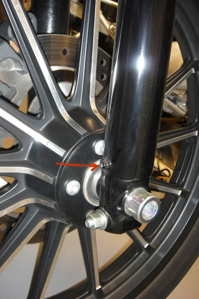

    Hi T1, the 2011 does not have the drain plug at the bottom of the fork.....I looked for it...I think it is under the fork so its necessary to take the fork out of the clamps and turn it upside down...i think...could be wrong. I was in two minds about draining the oil...do you think it would be worth while syringing out the old oil and replacing it with new. I have replaced the engine oil and primary with Amsoil and was going to replace the forks with 10w Amsoil fork oil...its what I intend to use for the bike in the future. thanks
  • terroristone
    terroristone
    You sure it dosnt? Look for this philips screw, place a screw driver in there, give it a few taps with a hammer then unscrew, this is the drain plug.
    T1
  • kojo
    kojo
    Hi T1, I was looking at a 2010 manual and it had the drain plug like you have shown...unfortunately the 2011 bike seems to be different in a couple of ways..you have to remove the front wheel to access the the screw. I tried that but was having difficulty in removing the screw so I left it, did not want to stuff it up and have to go cap in hand to a dealer to fix it...will take my time and learn some more. The information you have given me is a great start, lots to digest and think about....thought it would be easy!!. By the way I,m NOT 55kgs........shoulda bought a (Fat) Bob.
