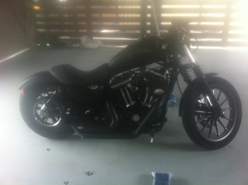

    Hi guys just wondering bout doing a wire tuk on my iron ive lifted the tank bout 1". pretty easy way if anyone wants to know. Is the wire tuk as easy as it looks. Just remove zip ties and plastic the tape it all up??

    Yeah it is just a matter of cutting the cable ties and a few screws, but taping to the frame is a rough way of doing it, it also looks like crap! Take the time to either make or buy a depining tool and remove all your electrical plugs and put the loom into some PVC loom tube with shrink wrap on the ends also, this will make it look factory and be heaps cleaner.

    Wire tuk all done just need to relocate coil n ignition.
    Makes a hell of a difference in looks n i lifted tank 1.5" roughly.

     More in line with the frame now!
    Looks good.
