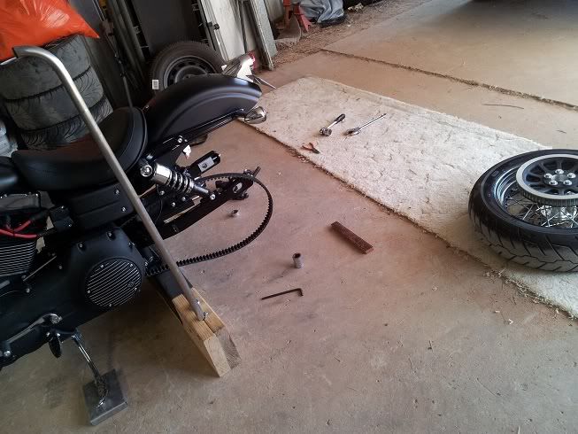

    Went to my local stealer today, asking about a 68T rear pulley, I had a list of P/N's that were meant to fit, turns out he had 4 of them, and was more than happy to spot me one, So home I went, and off came the rear wheel.

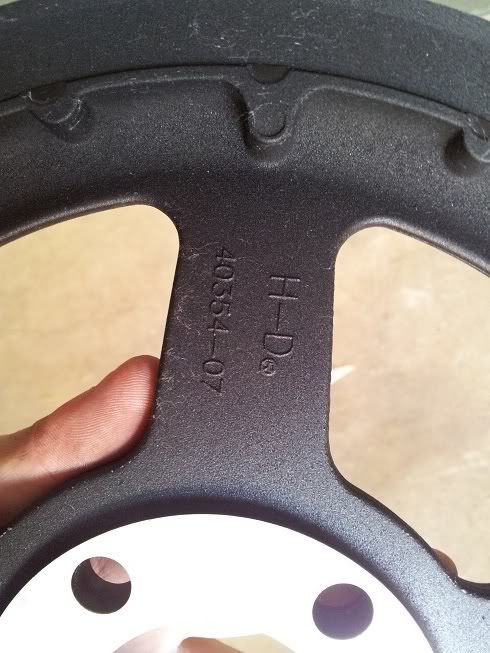

    Details of the original pulley

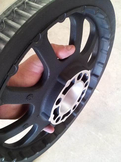

    Off set of original pulley

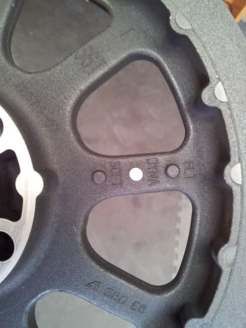

    Sportster pulley P/N

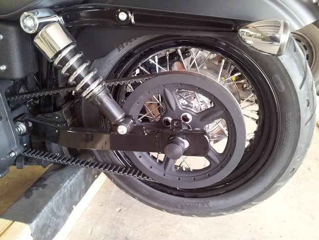

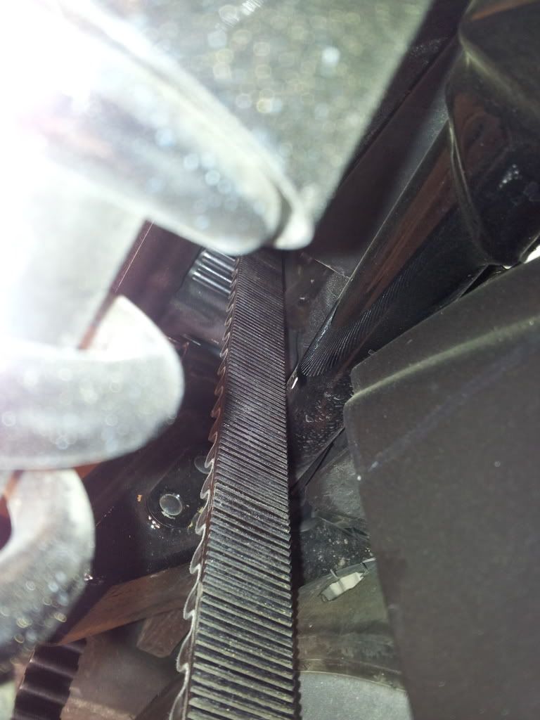

    Clearance Installed
    Finished
    I used some new 7/16 UNC high tensile bolts I had, 2 inch long & it all bolted up nicely. As you can see, It doesn't touch, and I have riden it & hasn't touched, but it needs a spacer, if you ever want to run a 180 rear or anything.
    With the help of Burto, I've got a 1/2 one on the way.
