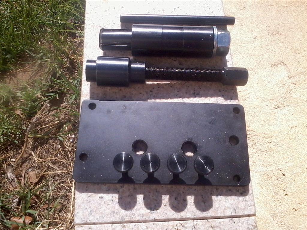

    I know it an old post but Hartland (spelling may be wrong) sell a cam bearing install and removal tool a lot cheaper than the others and it does a good job. Don't try it without the tool or you might be up for pulling the motor apart to get a few bearing bits out. Bearing tool above also works on the wheel bearings with a big socket over the wheel as a spacer to pull against, because as they have a spacer in the middle as well so its difficult to tap them out without damaging the spacer or wheel, worked well on mine anyway (25mm or 2007 and up). Attached a picture if you buy one off ebay, Amazon or online somewhere.
    Anyway how did the 106 and 54H work out?
