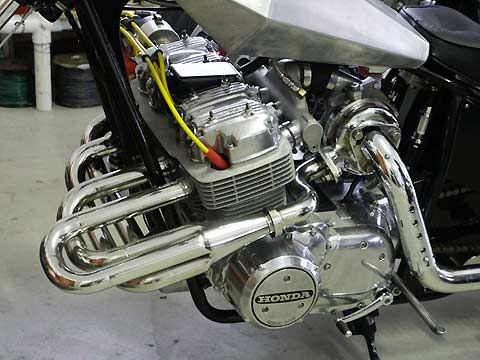

    heres some piks off a wait for it lol cbxhonda 750 in a softail frame i made with 200 ass end will look pretty sweet the young fella that owns it has not got the money for a harley so i made him the next best thing a cool old skool chop with a 4 banger in it will be a nice thing when finished also makin an inverted springer for the front end
    ya most prob noticed i take alot of pictures lol i do it cause 1/ i can show owners wat im doin an see if its wat they want ...2/so i can show ppl wat something will look like ....3/ so i can back up shit i say lol
