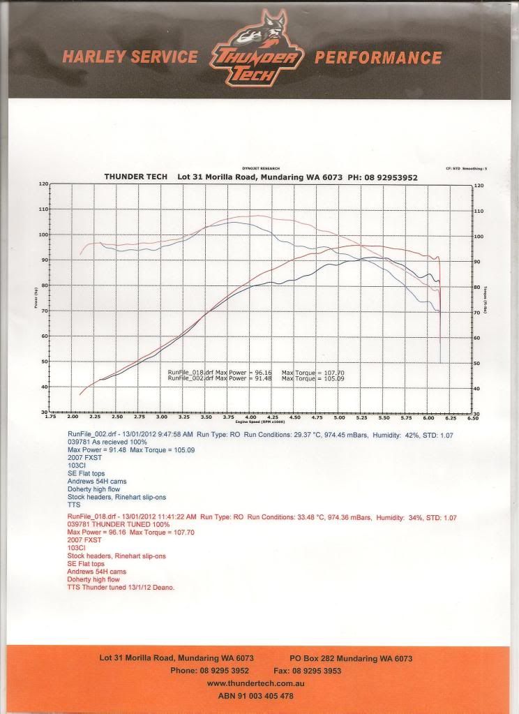

    Had my bike dynoed today at ThunderTech, very refreshing to be treated well and be allowed to get involved in the dyno process. Thanks to Deano and all the crew there.
    The dyno showed that TTS tunning is not easy and subject to error when not done properly...
    Got 96hp and 108tq, Deano was surprised with these figures cos it is with slip on Rineharts, and no major head work...I'm more than happy with the result...
    Got a glimpse of the new DynoJet vision, not a bad bit of gear...

    what were the readings before tuning on the dyno? and what camms are you running?

    Here's the dyno chart before and after...Quite a dif in the curve from my poor TTS tune to what Deano got out of it.... it's now got heaps of tq from the getgo...Realy noticed the difference riding home, gonna loose some more points if not careful FFS...
    The prime reason for getting a dyno done is that I was not confident that my TTS tune was right although the bike ran reasonably well...
    All up cost was $400, that was for about 4.5 hrs on the dyno...Also found that my regulator is faulty, seems to break down at higher revs...Probably the reason for my past battery hassels. Got one comming from SWHD (Deano didn't have one) will hafta look into the alternator as well, much bigger job to change stator though...
    Can't speak highly enough of Deano... Highly recommend ThunderTech.

    The reason for the dyno on my bike is that I knew my TTS tune was not right and I didn't want to go to the trouble of carting my lap top around and turning my brakes blue...
    Deano for mine is a very competant operator, he took his time and went over the figures a number of times to get it right. Oh!! and he sat on the bike while doing his thing...
    Money well spent for peace of mind...
