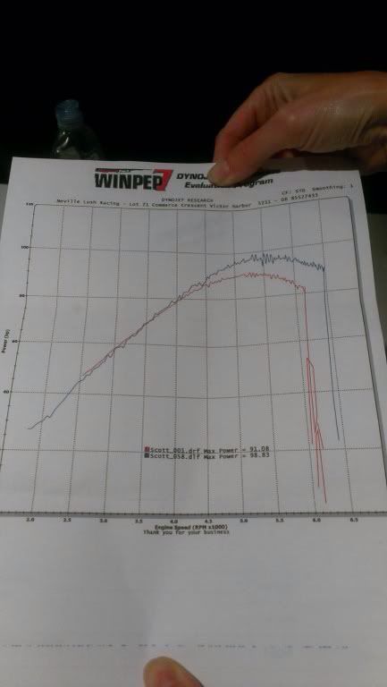

    99hp
    Sold the bike
    New owner dynoed
