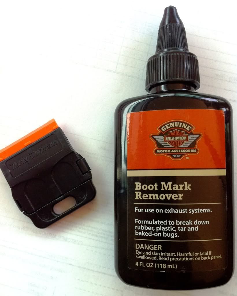

    A distinct blob of my daughters boot rubber was ‘welded’ to one of my chrome V&H pipes.
    It had been there for quite a few months; while I used and tried various products to remove the blob.
    One night at Harrys Café De Wheels (Liverpool) the King of Bling [Phantom] went to his RK panniers;
    pulled out some trusty cleaning stuff trying his hand to remove the blob; negative result.
    I was eventually pointed in the direction of HD Genuine Boot Mark Remover
    (For use on exhaust systems; formulated to break down rubber, plastic, tar and bugs).
    I also got me some HD plastic razor blades.
    Yesterday, I attacked the blob.
    It did require 3 separate applications; but the product eventually removed all traces.
    I’m extremely happy with the product.  Yep, it did take 3 applications of the creamy stuff –
    had to let it do its work over a 15 – 20 minute period then scrape away with the plastic razor.
    Just took me time and employed sum patience.
    I am happy cause it has been there a long time with the pipes being heated up then cooled every week or more;
    which to me meant it was being ‘welded’ in place.
    I reckon if I had this stuff on the day it happened or even a week later – the blob would have gone with one application.

    4got to put in the cost
    $11.20 for the Boot Mark Remover.
    HD Plastic Razors and Holder (Cant remember as I got it a few months ago).

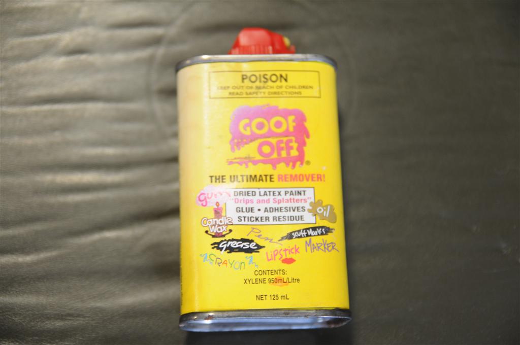

    I use this stuff. Put it on and wipe it off, it is fucking awesome! Don't get it on plastics it fucking eats the shit but on chrome it rocks, takes seconds to remove boot shit from your pipes.....get some!!

    Where did you buy the Goof Off?
  • Maxiboy
    Maxiboy
    I really can't remember but knowing me it was Bunnings. It work's though.

    Lipstick?
    There is no fucking way I would put that at the base of my knob
