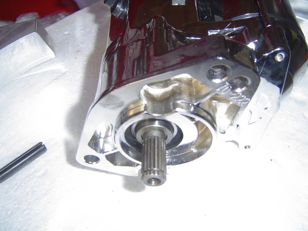

    Fitting a new Starter motor to my 87 FXSTC its a Spyke and has a "collar" around the starter to suit later model bikes. Can I grind the collar back rather than trying to drill the starter mounting plate that is on the bike?
    The following is from the instruction guide. There will be 2 x 6mm bolts as well as a 6mm locating dowel to hold the starter in place on the mounting plate.
    1. Installation on 1986-89 models requires the use of a 1990-up starter and modifications to starter mounting
    hole on transmission will be necessary. You must open the mounting hole up to 2-1/8 inches.

    The collar is essential for load absorption. Do not remove it.
    What primary drive do you have?

    you can just buy the right model starter for the job there's plenty out there,    they need the spiggot too locate ,  the bolt 's clamp it the bolt hole's are not a perfect fit  so the gear will not mesh proper ,     i think they changed them in  EVBT  1993/4 ?  that's  the size of the hole in the inner pri
  • daddyracer56
    daddyracer56
    hi ,    i would get the hole machined on a mill & centred proper @ least,   with a dremel it could be a  bit-off you don't have to go all the way through  just deep enough + 0.020 " what the spiggot is on the starter for a size for size fit  +  0.001" clearance only,   it depends how thick the open belt backing plate is       they are normaly thicker about 3/4 "-7/8",        are you in Sydney , any good machine shop could help with that easy enough as the hole location is already there ,

    PM Kiwidave, he has a shit hot machinist who done his heads down the east side and between him and Dave it won`t be a big issue, you`ve been off the road a while now so don`t rush it, check your Zeus book for a transition fit, tolerances are quite tight. You could always have another beer while you wait

    No separate plate (hence the instructions regarding the hole).
    Buying a new transmission is not all that crazy.

    Your new clutch has a taper?

    "Do you know if the 90-94 starter is a splined unit " Do you mean transmission?
    You could of course just use an 89 trans, as they had the same clutch as an 87, but the later type starter as stock.
    As far as I am aware, all single cam softail trans cases are interchangeable, provided you also change the starter and clutch and primaries etc.
    To my mind, the splined clutch is much better, and the gear ratios of 90 and later greatly improved.

     so you have the early pre 87 starter like a shovel style , when you said 1987 model  i thought that it's the 1st year of the later style self contained starter  unit  1987-up that the year they came out  , either change trans case or copy a later case buy maching the spiggot  & or welding  a boss in place but you will need  too copy  a 1987& up  trans case , what date is on  the frame  compliance plate  or look up the frame #  for the date  sorry not much help on this 1
