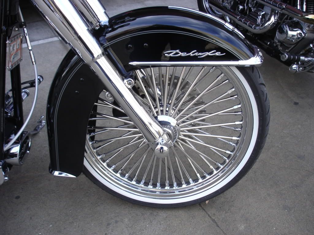

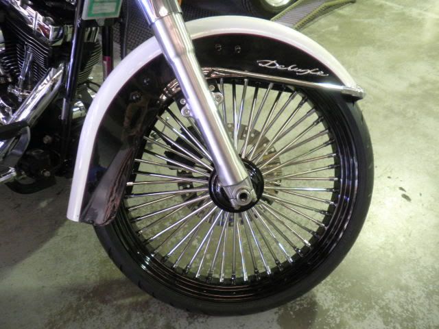

    Here's another customers Veto's Bike, This one is a 21 x 3.5 Rim with 120 x 70-21 Tyre, the Black Bike of Glenns is a MT90-21 on a  21 X 2.15 and the 23" is 23 x 3.5 Rim with 130x 60-23 Tyre. All under stock Fenders

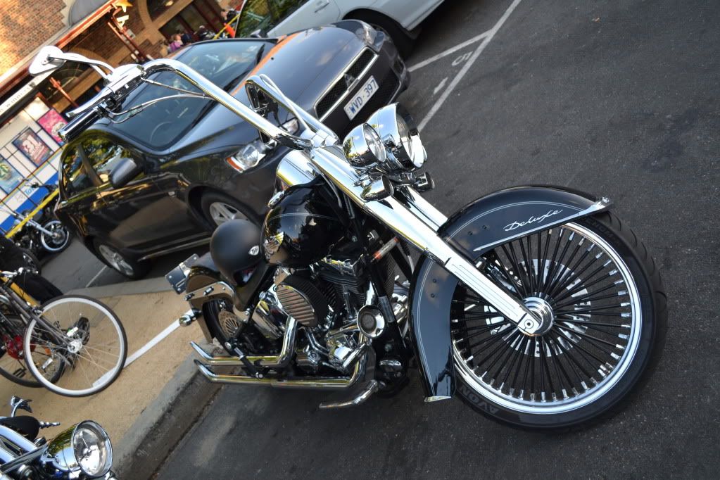

    Dunno if the 21 works with the fatty front fender but would look bloody awesome with a lux type fender,
    If it was my fatty I'd be going for a wrap style with a 21 & lower the front...
    Just my 2 cents tho

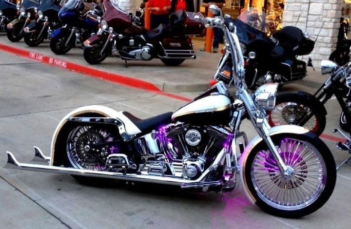

    Yeah - think I would change the guard eventually. I like something like this...

    ahaha!! Nice!! I am keeping rear fender and wheel dude... just might swap the front one is all. <img src=" border="0" src="/DesktopModules/NTForums/themes/_default/emoticons/smile.gif" />
    You can barely see the rear wheel behind all the hardware anyway, so it won't matter to leave it solid.

    Yeah man. I went to a local performance workshop and he had a RC Components 21 on a fatboy! LOVED IT!!
    Will go the 3.5 and get a 120 Metzler 70 (low profile) It looked real good.
