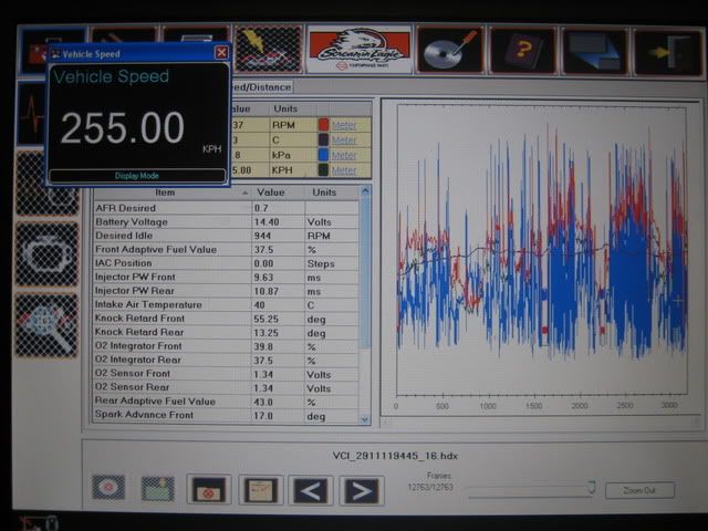

     Ah well, truth be told........she don't really go that quick!
    Seems that on the last frame on a data run before it runs out of recording space, it maxes out the speed to 255 for some reason.

    how are you finding your data runs ?
  • BURTO
    BURTO
     The data run set up on the SESPT is well set up. You can move any 4 of the data items from the lower list up into the top box which will put them on the graph to the right. It has been real handy for adjusting my timing curve. I had front and rear knock retard, MAP and revs on the graph so it made it real easy to see where I had to pull timing. You can change the colours if you like and bring up the bigger boxes for each to make it easier to read at a glance (like I did here with the speed).
    The "smart" tune application, however,  they can shove up their arse!!!
