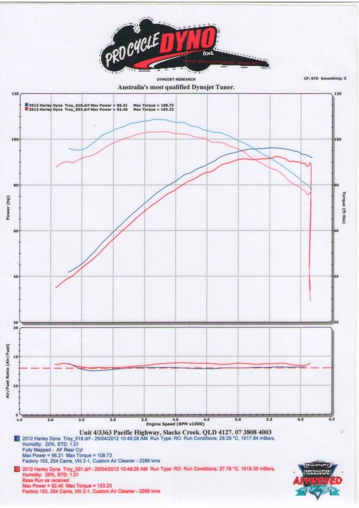

    I Know this is an old post but this is what iv got on 2012 Fatbob with 254E cams
  • Dinga
    Dinga
  • ozymax
    ozymax
    Dinga thats pretty good numbers and it's early in the RPM,
    What tuner are you useing?
  • Dinga
    Dinga
    G'day Oz, I'm just running a SERT tuner. Fred at Pro Cycle in Underwood is the man
