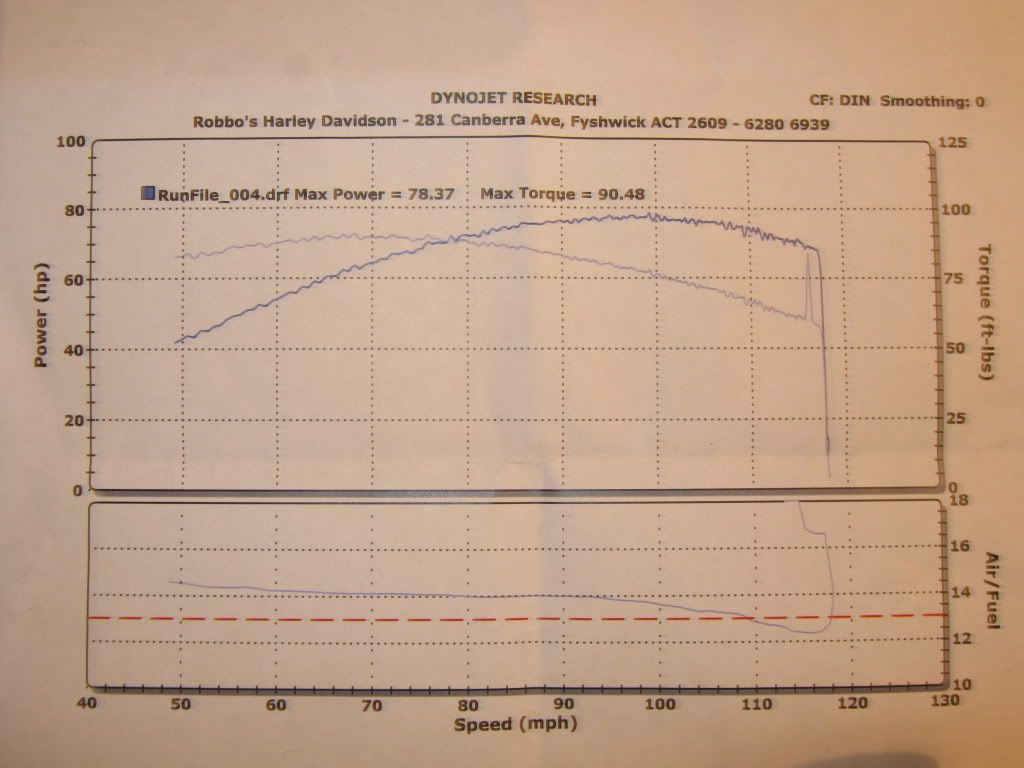

  • BURTO
    BURTO
     For comparison purposes..............
    2010 96ci Fatbob
    K&N air cleaner
    BUB Lakester 2-1 pipes
    TTS Mastertune
