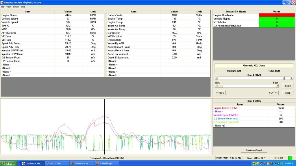

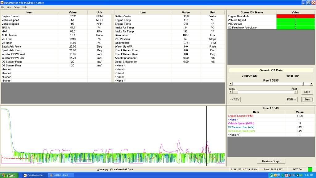

    I ran a data O2 Run on the way to work and will post some pics when I get home tonight.  I can't load them up from work.  I feel I have some funny results.  From what I can see the O2 Voltages are dropping to around the 50Mv but need to check the TPS % to make sure I am accel and not Decel. But even with Decel I should be getting something out of the O2's and the BPW both front and rear is very high in these areas.  Someone will be able to advise me what I am looking at

  • AJ56
    AJ56
  • AJ56
    AJ56
    Pic of the data run this morning.
  • AJ56
    AJ56
    There were a couple of places that the MV for the sensors were at 0.. Now it could be that the Target AFR is 13.4, and the MAP is 88.6. So noot sure on that side of things. But the 2 places where I was able to open up and get it to that area this was what was recorded.
    PS disregard the lower hand side in the columns as I had the mouse over another area of the graph. The next pic is a blow up of that area
