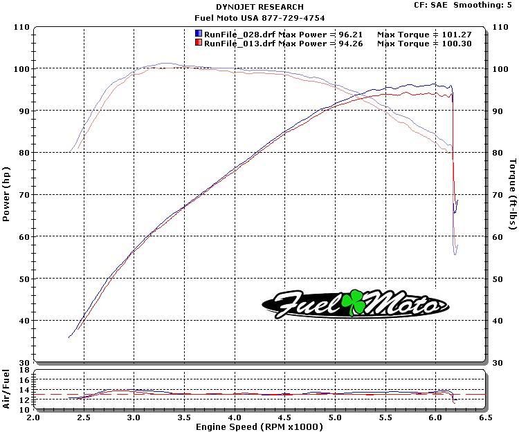

    Hi Ozroder, I am interested in your comment about the Woods 555 needing compression?
    Fuelmoto did some extensive testing on the dyno with the Woods 6-6 and the 555 as a "bolt-in" cams and the results were amazing.
    Here is the dyno chart showing both cams bolted into the same bike - stock 96" with pipes and a/c on the same dyno.
