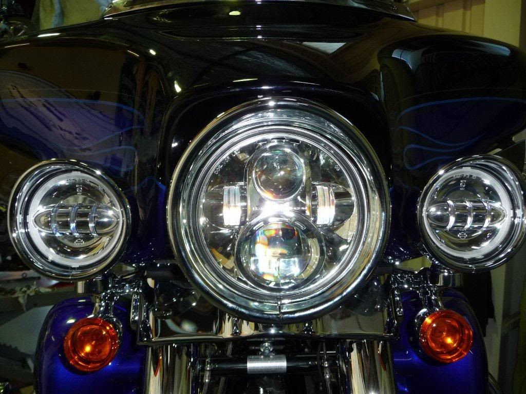

    Hard rain, wondering if anyone else has had this problem.  I need to reseal them, as moisture gathers on the inside of the lens when not in use.  Maybe came in the mount?  Or past the front seal?  Thinking of a bit of silicon, anyone had a play with this?

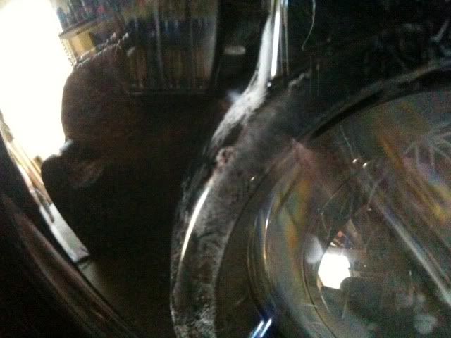

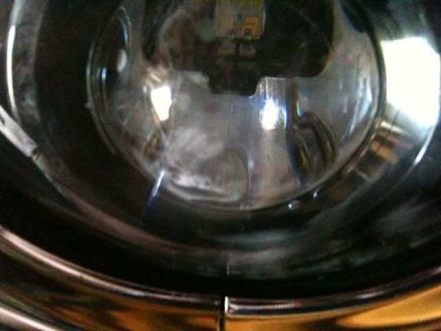

    I have had the some sort of issue with mine except I letting Harley Heaven sort it out as it's only on the the main light. It looks like someone has tried to finger print it. here are some pic of mine.
  • als1200
    als1200
    Warranty , let the stealers sort that one out. Should be ip65 rated.

    Mine is in the Shop, will be picked up today, added a little more bling chrome engine/ tranny bolt sets, upper bag LEDs, chrome inner primary, bits and pieces and re-seal of the LED Passing Lights..   The CVO Forum in America picked up that some of the LED Passing lights/ Driving Lights, were not sealed properly with just a sticker, when there is a rear access hole on the back that needs to be coated over with silicon or epoxy..
    Will post what they found, but evidently the LED Driving lights are like a sealed bulb, only there is a hole on the back that needs to be sealed better.  I thought it was a separate lens sort of affair, and it was just a reseal or rubber gasket or silicon seal on the front, but I guess it is a one piece LED set up.
