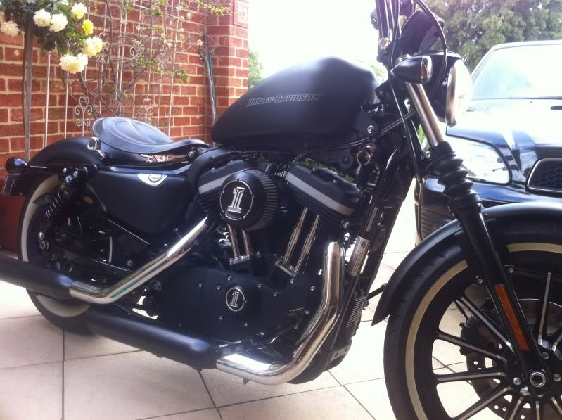

    slammed a new aircleaner on today. wasnt to sure if the old bracket was needed it seemed to fit better with it off????

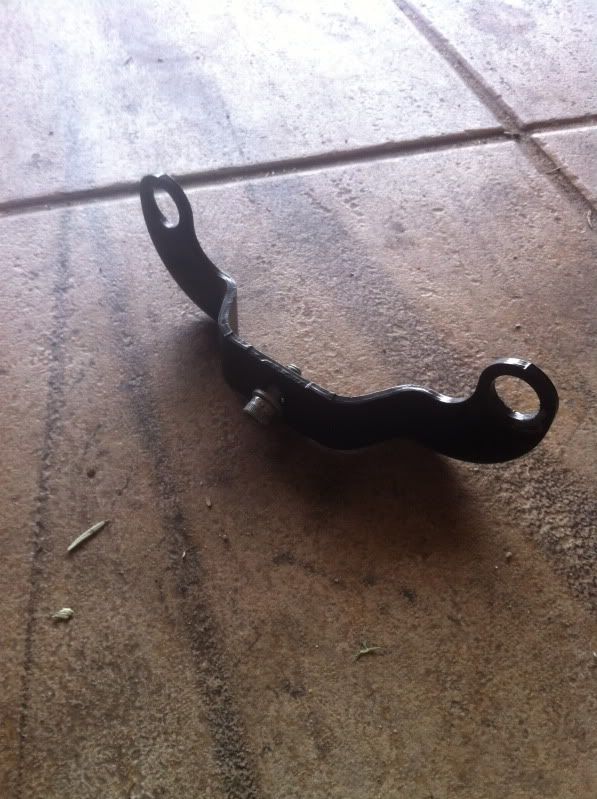

    this bracket

    Looks good mate, that bracket supports the throttle body and is needed!!!

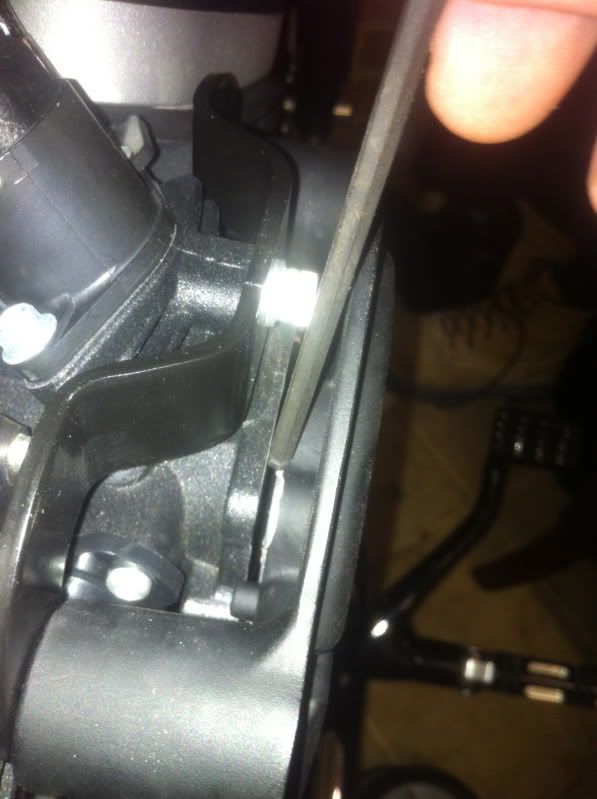

     okay so i just put the throttle body bracket back on and the backing plate for the air filter, you can see in the picture there is a gap between the throttle body and the backing plate around the same thickness as the throttle body bracket, so there is no way it should be going on!! thoughts?

    a little hard from the pictures, if you fit the backing plate without the bracket are you able to fit a bolt thru it to the throttle body so it is supported?

     that allen key is basically sitting in the gap, i think the screw hole in the throttle body may be higher then then backing plate, if not there yeah ill chuck a bolt all the way though it, cheers

    if you remove the brace, can you bolt the back plate to the throttle body? if so leave the brace off. if not you will need to do some modding.

    That air filter also bolts to the breater bolts, correct? You dont need the bracket...
  • darkdesign
    darkdesign
    my understanding was you need the bracket for carby models, you don't for efi.
  • terroristone
    terroristone
    Thats the factory bracket he has there, it can be removed if the new air filter bolts to the throttle body and not just the breather bolts.
  • calum883
    calum883
    yeah i think we can knock this one on the head, the airfilter backing plate bolts to the throttle body as well as the breather bolts so she be sweet with out the bracket! cheers for the help

    nice. what that set you back?

    Or if your in doubt you could put 2 throttle body gaskets on to make up the difference in the gap.

    I nearly bought the same a/c & cover. That's the billet cover right? Nice.
  • calum883
    calum883
     yeah its a pretty awesome looking filter, not a fan of the really small ones. 270 bucks all up from perth hd 158 for the cleaner kit and 113 for the cover ( cover is a rip off)
