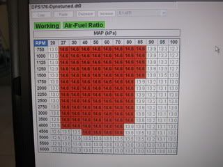

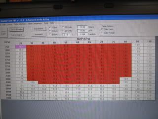

     Because I am unable to tune new 2012 Dyna with TTS as yet, I have bought a SESPT to tune it.
    I had already completed a TTS calibration for my build thru Vtuning and then Dynotuning to complete it. This cal I was extremely happy with, and since I am building the new bike to exactly the same specs, I want to use this same cal again.
    It was easy to copy and paste all the tables from the TTS cal over to a SESPT cal. I started with the closest cal I could find on the SESPT which was basically the same as the TTS  PS176(mt7). My TTS cal was based on the DPS176(mt8) which is not that much different.
    The only thing different was a few cells in the AFR table. The SESPT has an 85kpa column, which the TTS cal I used didn't, so I was able to run the afrs in this column in closed loop up to 1500rpm as well. Also a 27kpa column that I can run in closed loop to 4000rpm.
    Check the photos............
    TTS
    SESPT
    The SESPT does not allow you to change the following tables (well as far as I can see so far anyway).............
    PE air-fuel ratio
    PE Spark
    Spark Temp Correction
    Closed Throttle Spark
    Adaptive Knock Retard
    IAC Crank to Run
    EGRs and
    Minimum TPS for Baro Correction
    No Cam Selector either.
    Except for the Cam Selector, none of the others I have changed anyway and the average joe probably wouldn't play with these.
    Not sure what difference the lack of cam selection will play........but hopefully not too much!
