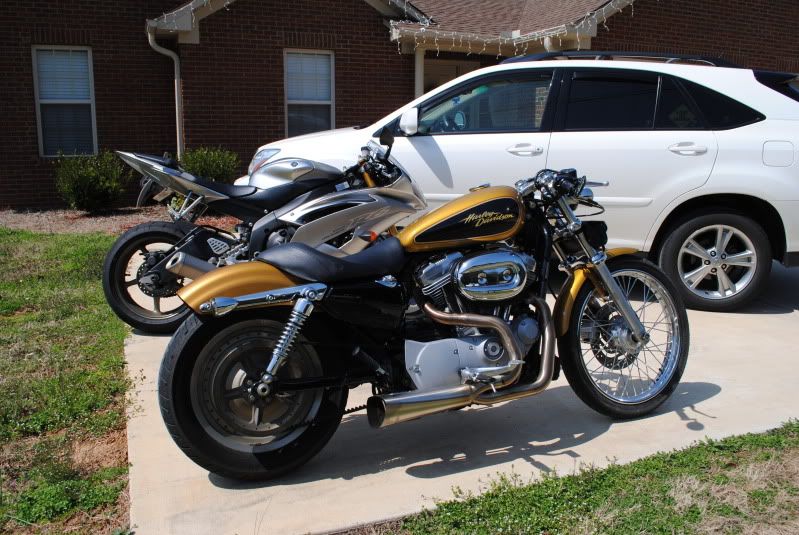

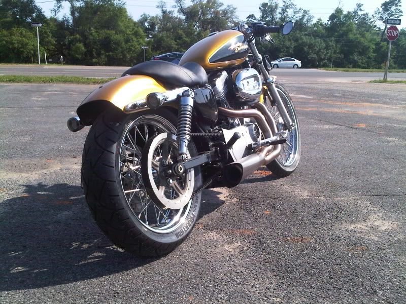

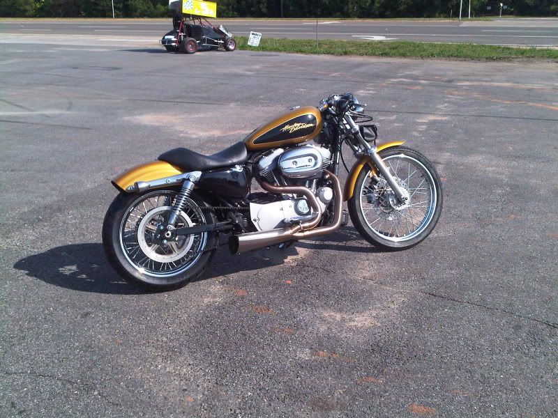

    Let me know how you go with the rims, have a look at these:
    Before
    After:
    Looks awesome!
