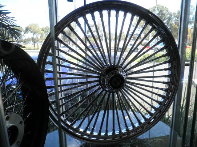

    Walker - do you have 23inch front with Chrome rim & black spokes?
    Its for my 2005 softy with 3/4 axle

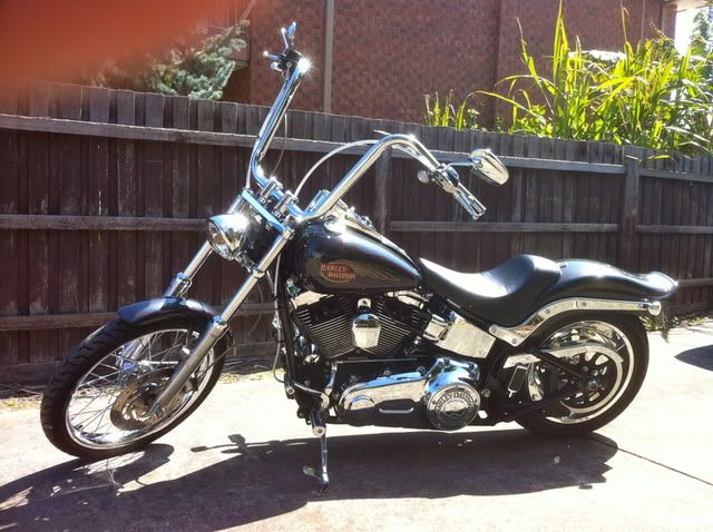

     Yeah when they go on I'll dump it on it's ass and push the bars forward 90 degrees should look alright . I was gonna put a smooth lace original spoked wheel on the rear but could not find one and Peter Stevens wants gold for it 900 bucks .
    All my Max Spoke Wheels will be in mid Jan,  This is a 23" that we supplyed a customer a few months ago

     I suppose if you saw the whole bike it might look better . I reckon they look awsome when they put 21's  with white walls on Deluxe's and Heritage's .

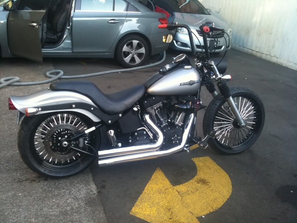

    Fitted mine  from Ian shitty photo gotta take more . Does anyone know anybody who does white walls in Melbourne? cheers

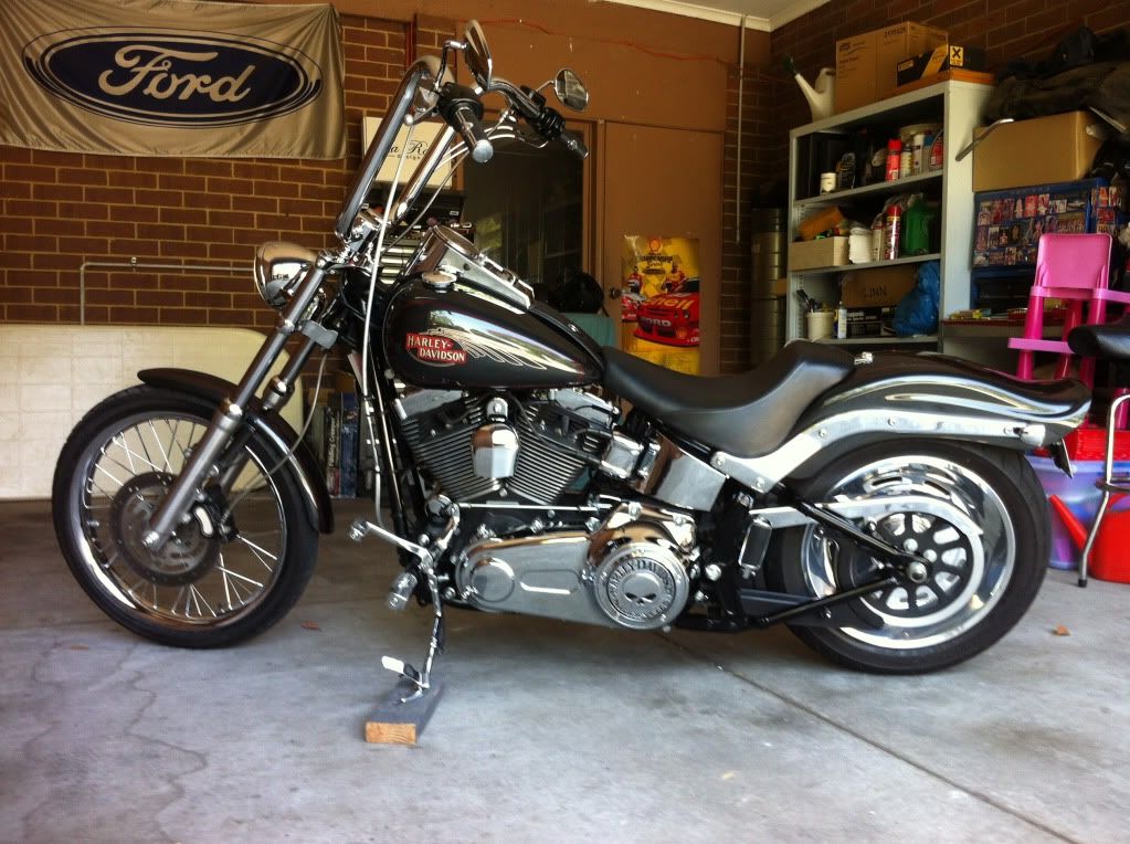

    Here's a before shot

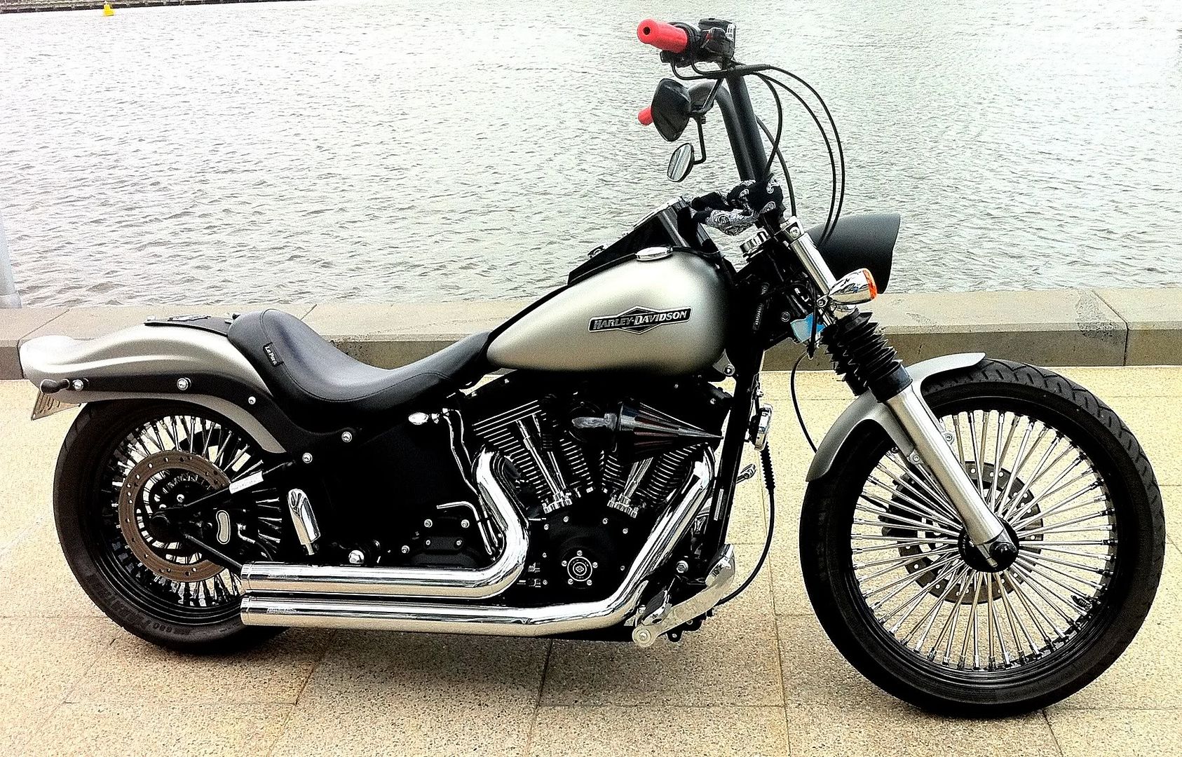

    Hanging to see what ya bike looks like S.D.M.F   I have the exact
    same bike but with v&h big radious and am looking at puting a 23 on the front
    in the future.

    Looks the grouse
    can you get that front wheel  in a 23 and also
    can you get a 23 front tyre white wall ?
    thanks.
    looks great Dave with 21" on the front, I dont know why they dont come from the factory like this

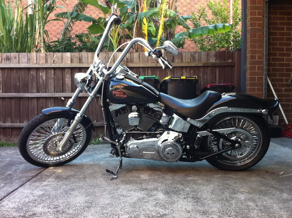

    Ok been following this thread with some interest. I live in Bum Fuck Idaho so all my research is web based (and that is not something I have hours to use) as opposed to meeting the locals and swapping info, or popping in the local custom shop. My Bike is an 2008 deluxe without ABS.
    Couple of questions,
    Looking at the Attitude Inc Rims in Chrome
    1: Does a 21" front wheel fit without modification in relation to brake and guard and spacers. From my reading it does?
    2: What is reqd to fit a 23" front wheel eg Guard mods brakes etc. not sure on this one.
    Obiviously I would like to match the rear to the front in the same rim. Is there room to move to a slightly larger rim and tyre without guard, brake etc mod? eg a 16x3.5 as opposed to a 16x3.0 and maybe a slightly larger tyre than the std MU85/16
    What do the Tyres cost  approx? been to Vee rubber site and no prices listed.
    Not the best picture but would appreciate feedback from those in the know.....(both know how to smile for a camera apparently)

    Our Max Spoke Wheels are to fit up to 2005 Models, SDMF's Bike is a 2013 I think,, We did change the Wheel Bearing to 25 mm Before they left here.
    I do believe the Front Wheel when straight on and New Rear Spacers and a 3/8 Pulley Spacer was needed for the Rear Wheel, The Bike did not have ABS.
    Metzler and Avon both make a MT90-21 White Wall Front Tyre that will fit the 21 x 2.15 wide rim
