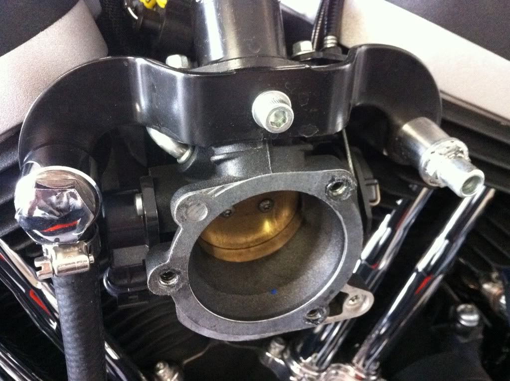

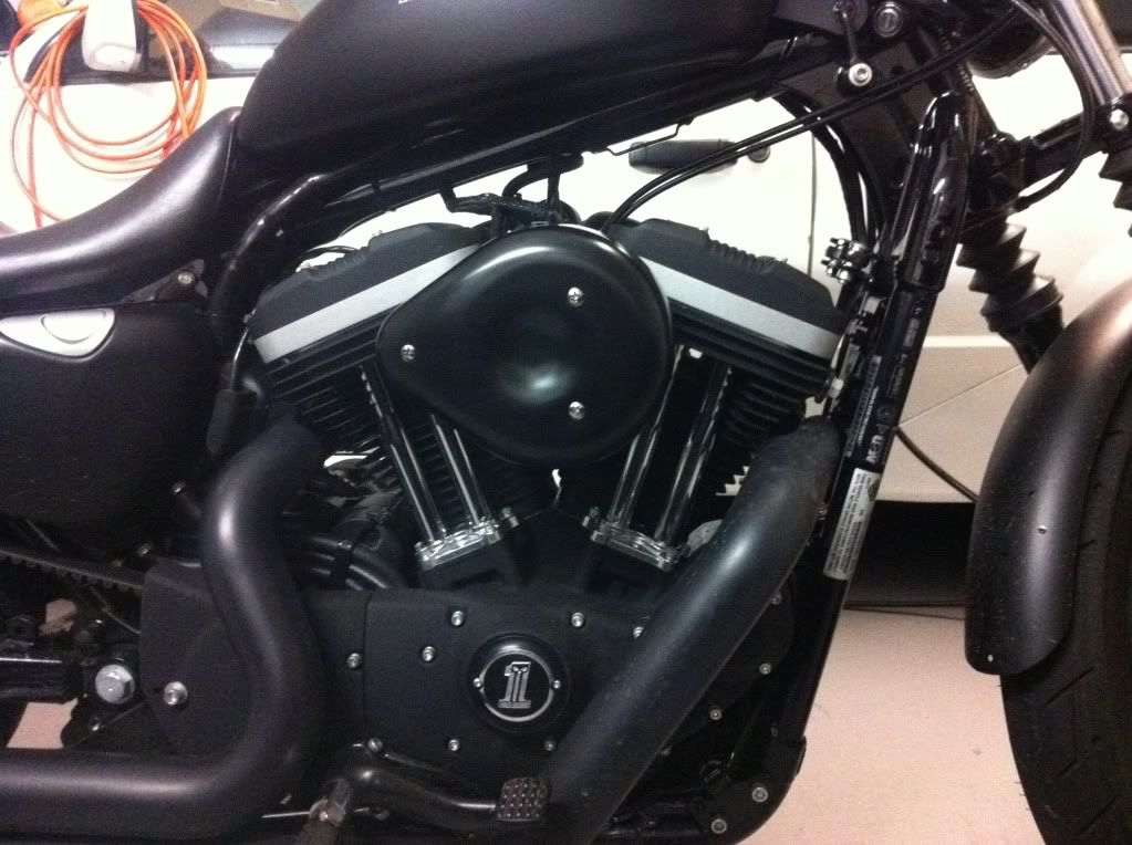

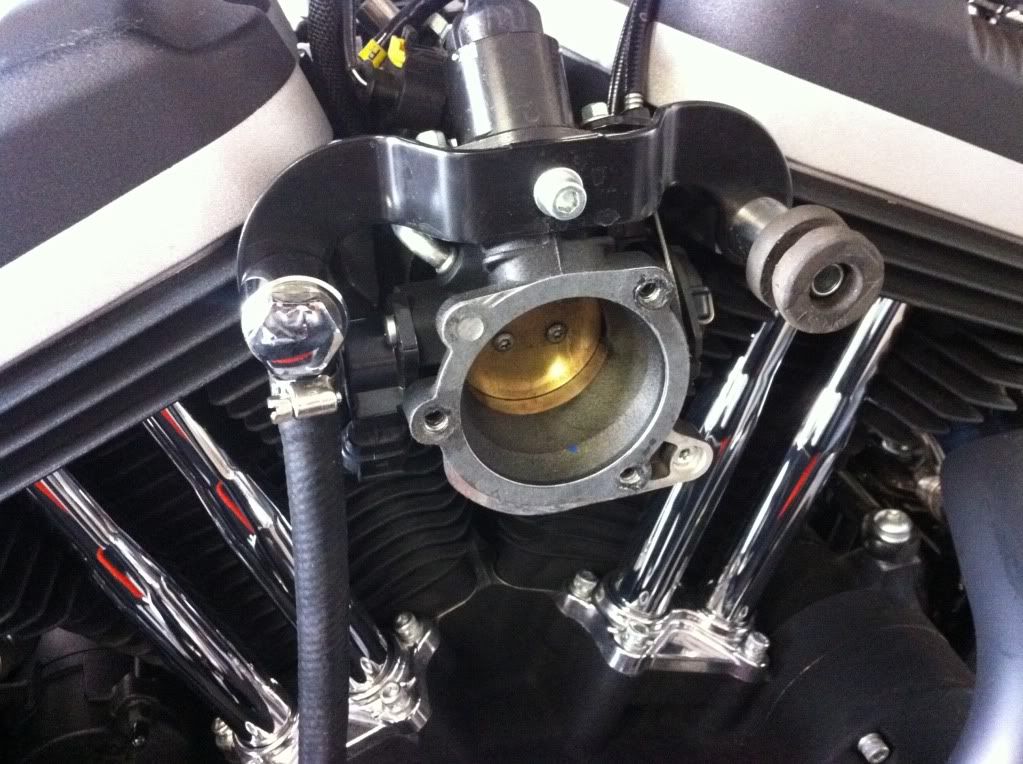

    Hey guys, thought i'd show some pictures of my new air cleaner S&S style Air cleaner that i got from Walka (Ian) @ VPW.
    This type of air cleaner is mainly used for carby models, but there is a kit that you can get from Walka that will help with fitting it to the EFI models.
    This kit comes with a small little filter that is used for the rocker cover breathers and there is alot a sortment of fitting/bolts/nuts and washer.
    I decided that i wanted the breather to run back into the air cleaner so what i did was use a mixture of the stock parts and the new ones, i drilled a hold in the back plate of the air cleaner to line up with the front breather, i made an allot spacer 15mm long so that the fitting would fit into the back plate and seals off with a large rubber o'ring.
    The rear breather i used the fitting that came in the kit, there was already two 1/8th gas thread holes in the back plate to take either a straight or right angle that came in the kit, i chose to run the barb from the right angle as it was to take 1/2" hose (too large in the case) and i drilled and tapped a new 1/8th thread in it so that i could screw in the 3/8 barb. I fitted everything up with loctite and seems to be all good. The kit also came with a new throttle body/carby brace but i used the stock one instead.
    Also thanks to walka for a good price and fast shipping!
    Regards Andrew.
  • 48fan
    48fan
    noice
  • Oldman
    Oldman
    Looks Good
  • terroristone
    terroristone
    Thanks guys! not sure if it me but i took the bike for a blast before and it feels a little stronger.....
  • 883n Harley Convert
    883n Harley Convert
    I like it, gives an old school touch to a new bike!!
