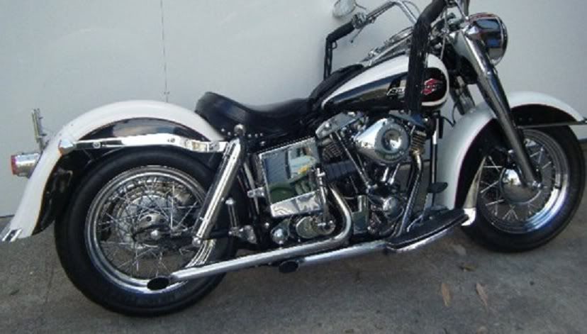

    I am Old School, as far back as a 66 Shovel in a 57 rigid frame and jockey shifter...  And a 69 Sporty, a 900, and a 73 Shovel in later years...  8 Harleys later and I currently have a new Ultra.   What about this for second bike "hanging out in the wind" for a ride now and then and to tinker on...  Old School FLH.  Fun to tinker on...  1340 cc, kicker and electric, and a lot of chrome... Hard chromed engine side case, chain guard, tranny end case, brake drum, front caliper, rocker covers, primary cover, full inner primary, shift linkage and mounts, brake mounts, just about everything practical old style hard chrome plated and acorn nuts.  A real old school tractor in style, and as a 1982 Shovel, this might be the nearly the last kick start Shovel?  I know it will be a tractor to ride, that will be the fun, and make me happy to park it up and go back to the new Ultra..  Still get parts for these?

    This has a front disc, all chromed calipre, chromed rear drum...  I comes with an original speedo, with 39,k miles on it, and it says POLICE SPECIAL.  With the Kicker and electric, how does that fit with the picture.  The story is that it was fully restored about ten years ago, with engine work and all this chrome, and brought in from America about two years ago and not ridden much.  The Aussie speedo on has like 1600 kms or so on it.  Looking at it: I am guessing someone has done all this custom hard chrome to a Police bike...
    How does that fit now?  Is it possible?  It fits the paint job, like original colours, but I do not know what original was in that year.....  Evo lower?
    Don't really know what I am looking at here, but the personality of it grabs me..  I would like an old Panhead as old as me, but they are rare as rocking horse poo so.....  Thanks for the help.

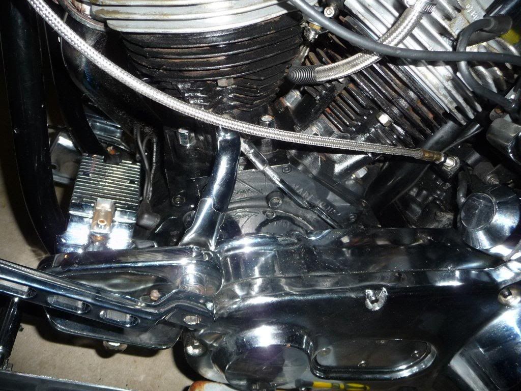

    I really appreciate your help.  I will try and get some detailed pictures, swingarm, frame, lower end.  The engine numbers are something I have NEVER seen, they are backwards and reversed as if it had a fairing and you had to look at it with a mirror.  And I did see the POLICE SPECIAL speedo that comes with it in good nick and 39k something in miles.  I will get pictures, as I cannot remember if the swingarm was round or square for instance.    I thought it was near the end of the Shovel, and the biggest you could get with a kicker... That and maybe $5-6000 or more in hard chrome made it a bit fun..  Chrome gets you home... heh he..
    Looks like you have Delkron aftermarket cases, its the only time i have ever seen numbers like that.
    look at the heads near the plugs for casting dates and on the frame castings,gearbox should be rotary lid, from what i`ve seen  it looks like a bit of a mix n match, nothing wrong with that, if you like it buy it but in todays market there are a lot of shovels for bargain base prices, good luck.
    What are the first 2 digits on the frame no?

    Mmmmmmmmm, as Dave said, badges are 63-65. Round swingarm with rear drum 70-72 Shovel, changed to square tube with Disc brake in 73. Reversed numbers?, aftermarket cases as Houli said. Check the tanks petrol outlet, does it have the latter left bottom of tank outlet or the front of the tank with the control rod at the top?. IIf you have the rod type, you have a set of original early tanks. Aftermarket never made those.Count the number of fins on rhe barrels. 10 fins it's a 74, 9 fins it's a 80 cube.Rear hinged fender with the early tailight points to 72 or older. Then again my friend you could have a bitsa based on an early look but done up very nicely. Either way I think it would certainly attract attention.

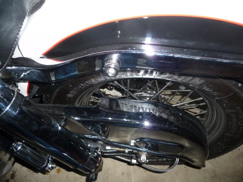

    There is something not right with the back guard?  looks wrong some how.
  • The Don
    The Don
    G'day guys,
    you are right Houli, when looked at closely it appears the guard is off centre, it's too far to the rear. Whether this was done in order to suit a taller person (by installing the seat  slightly back) or to make different year parts fit I'm not sure.

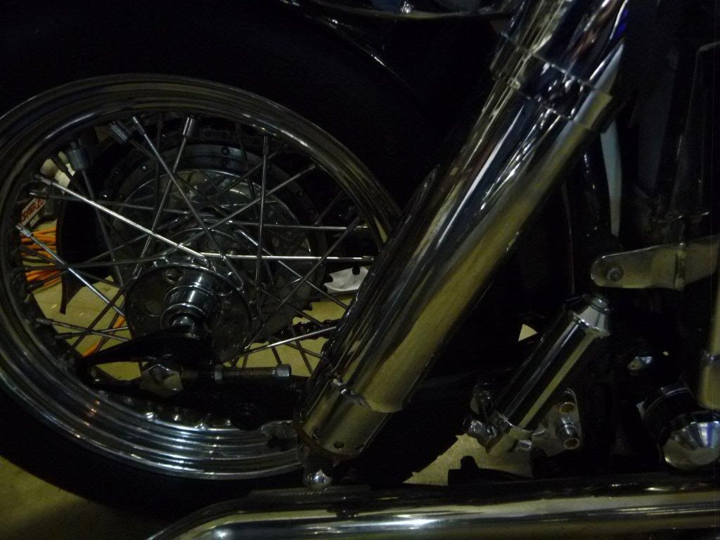

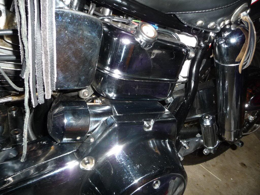

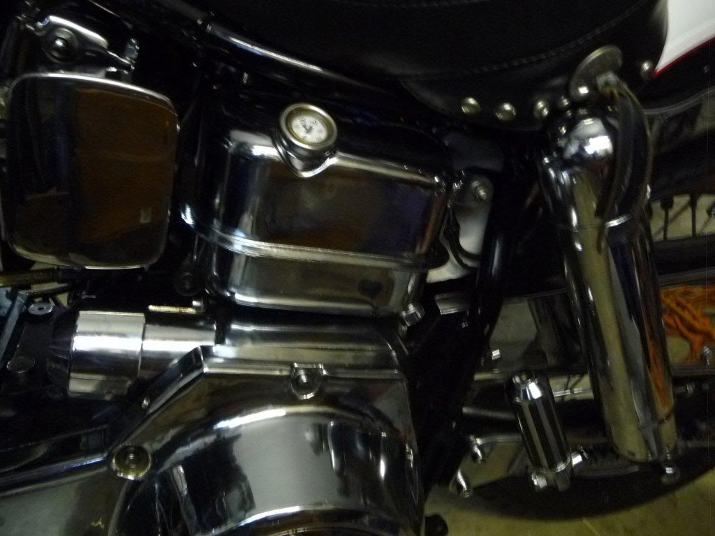

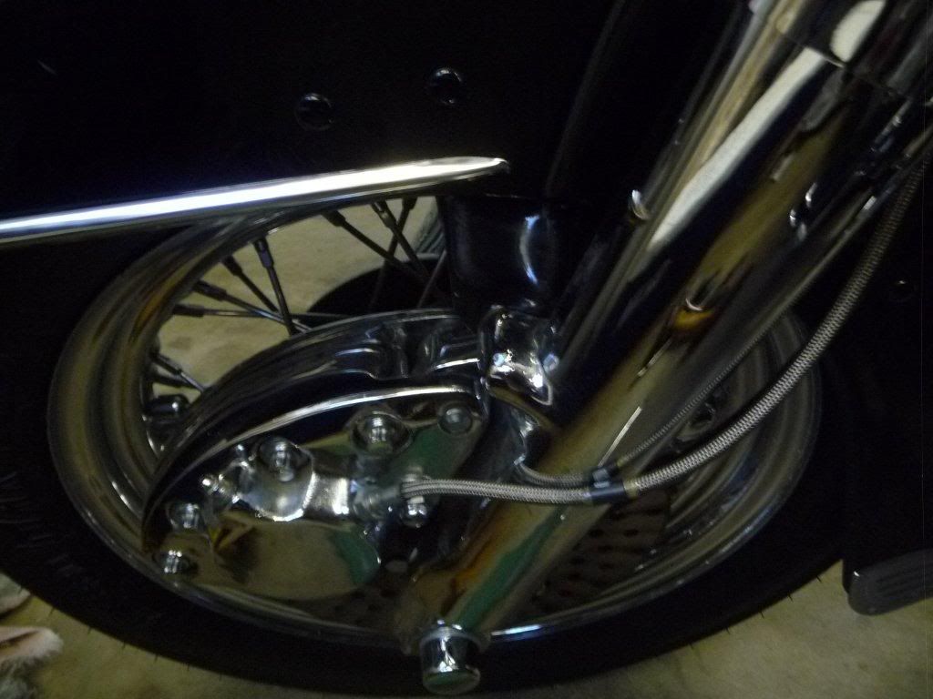

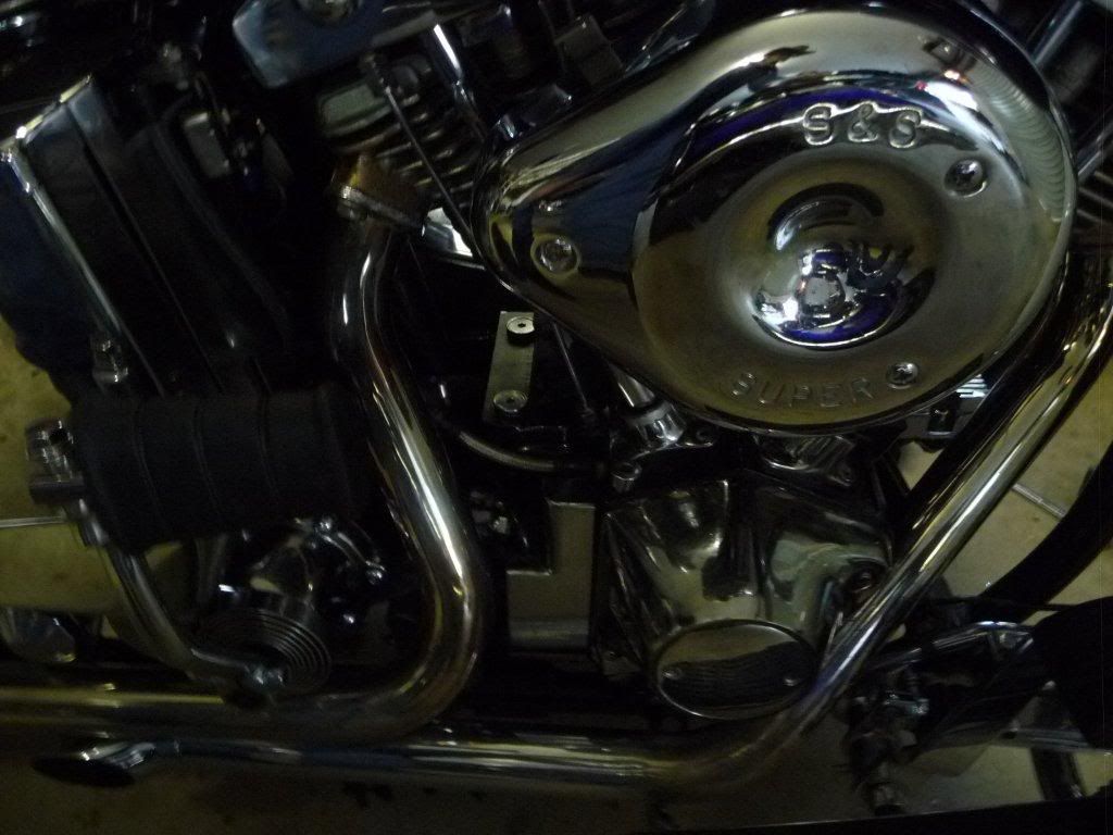

    Thank you for all your input...  I am still doing my investigations, but it definitely is a "Bitsa" early 80 c.i. done up to look Old School with a lot of vintage equipment.  It is hard for me to put a value on it, but it has a lot of the gear I just like.  Like the front end is done up in all chrome all the way through the lower legs to the full calipre in quality looking chrome.  The wheels look brand new, and it has new or near new Metzler tyres.  Inner primary is chrome, starter, oil bag, tranny end cover and kicker, cam housing engine side, battery box, oil pump, shocks, rocker boxes, all in chrome and it appeals to me.  A rider with the early vintage style to it...  I may still bite, as OK it may only be a $9000 shovel, but it has about $6-7-8,000 in goodies that I would like to have.  All the way down to the chain, it looks high grade, on chrome sprocket, chrome drum, controls and clutch and brake handles, the works...  Everything to the oversized chain FLH chain guard has been done in chrome...  Maybe I am just a sucker for the chrome and early look...  I would like an old Panhead or early Shovel, all original restored, but we are talking BIG money then..  This is just a bitsa rider with the old look I guess..
    Bitsa pictures,  So, I am just an old fool parting with his money?

    On research, yes is a bitsa, done up to look early 70's shovel with a later 1982 80 ci  Shovel engine.  Sometimes you are just struck by the character and it has happened to me...  This bike just talked to me, and with all the goodies it had that are very hard to do like chrome calipres and chrome full front end, rocker covers, engine and tranny sides, inner primary, and the rest that I like, I decided it was OK value.  I want to start playing with classics a bit, maybe even try to import..  This one is a good start for a Rider, as it has most of the things I have always liked and cheaper than I could build.  Thanks for your help Guys...
    I will start with rework of wheel bearings and axles and anything in the Primary, and the rear wheel can move back 2" with a new chain...  S&S super is running rich and stinky at an idle, will have to lean that out a little...  Then I will start improving things for reliability as a local rider.  My junkpile has a two up seat and sissy bar that will fits, suspension for the solo is a must, play starts today... heh he..

    Oh, and Houli, you are right again... Twice...  Now that you mentioned it, (I am so dumb I did not even notice it)....  The chain is too short, wheel needs to move back about 2 inches, adjustment is all the way in, it will look better with a good 4 maybe 6 extra links in the chain. (too bad the chain looks new as well)...

    I thank all of you for the help.  I am doing front and rear axles and bearings, dropped primary cover and am going to replace primary chain as it is near the end of its adjustment.  One bright spot is a five finger clutch pack and pressure plate that all looks new...  Houli, now that you pointed out the rear wheel being forward, I have realized the chain is too short, so am ordering a new chain a few links longer as the adjustment is backed all the way out and needs to come back about 2" ..  Adjust valves, oil and filter change, primary is an oil drip and scavenge system, all looks good.  Some new bits on the way, and She will be a dependable tractor around local...
