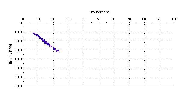

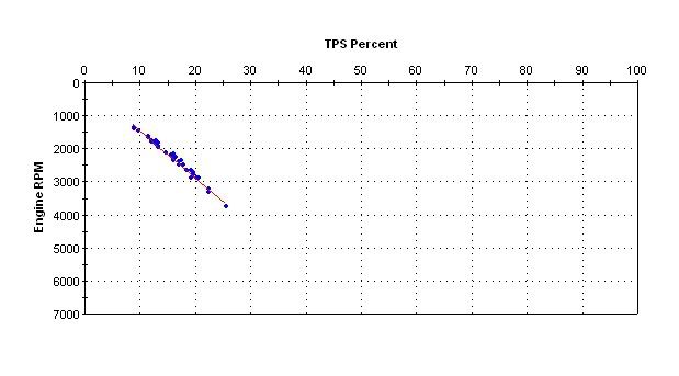

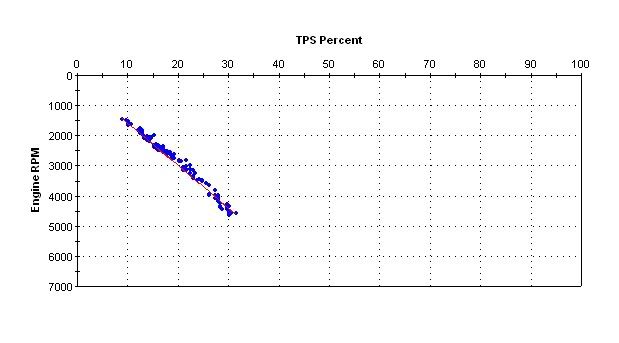

    I have started doing some tuning on my bike  with the new MT8's  I collected 3 V Tunes today but didn't touch the EGR tables as yet.  Here are the 3 runs,  after the first run I though holy shit what is going on here but you can see after the 3rd run a marked difference in the effects
    Run 1
    Run2
    Run 3
    Now I intend to do some more runs again next weekend weather permitting.  But I am thinkiing that I will not have to make any adjustments if it keeps going the way it is atm.  A hell of a difference between the 1st and 3rd run.   Still going to look at the VE's and do a bit of tweeking and see what affects that has on the EGR plot.  I am still trying to get my head around this as well, so it is going to be a long slow process.
