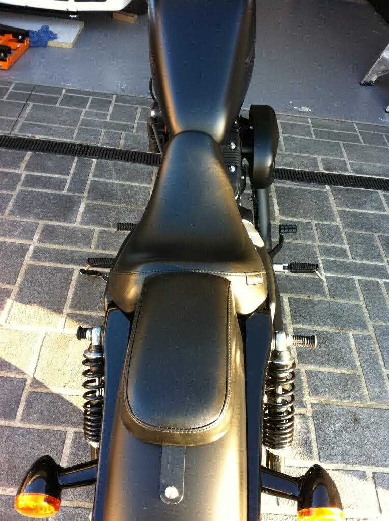

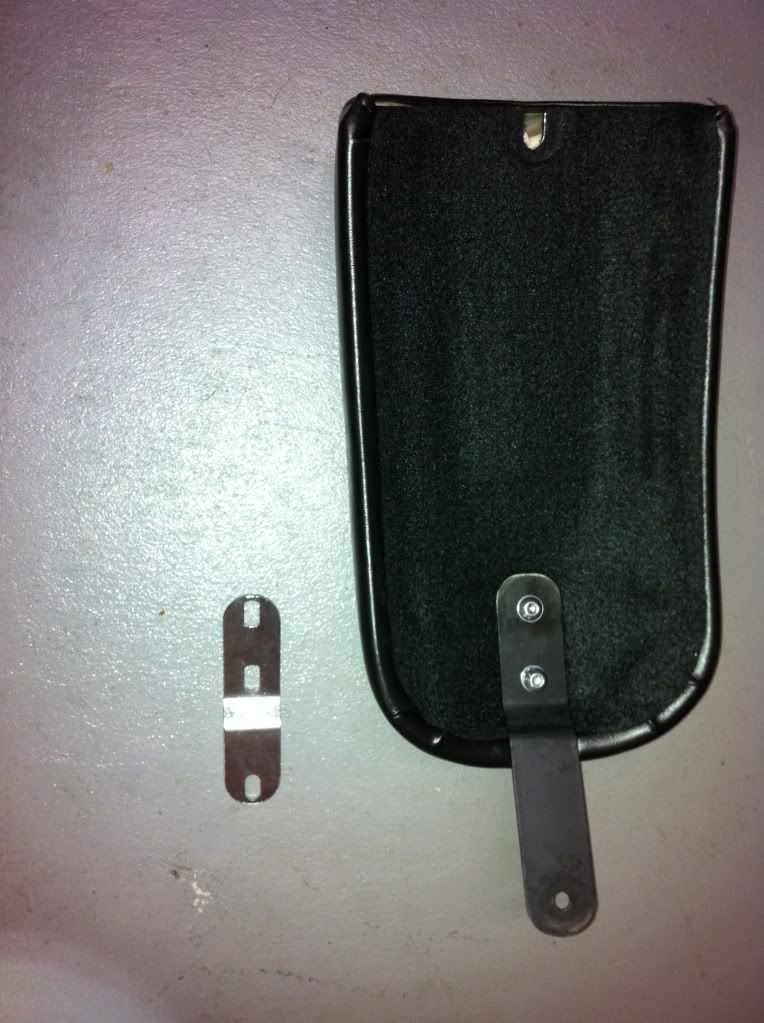

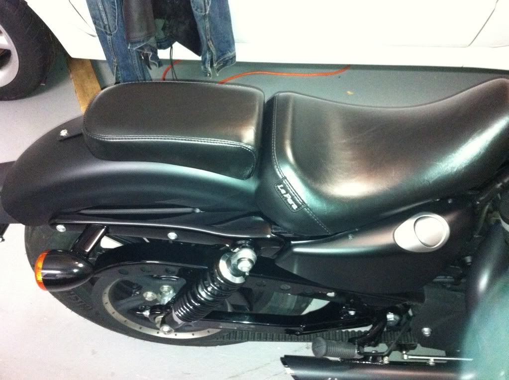

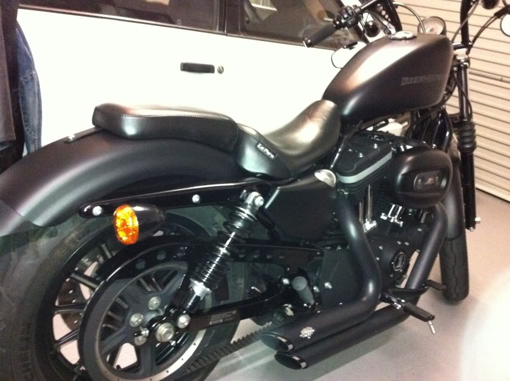

    Hey guys, i have recently fitted a Lepera barebones LF-006 (04-06) seat to my Iron (which is basically bolt on), then i looked at a pillion option for my miss's, it seems that Lepera do not make a pillion for this kind of setup, so i did some looking around and a little measuring and even spoke to Lepera themselves, and it looked like the L-006P would be the closes fit. So i went and ordered one, upon arrival i noticed that all i needed to do was make a new rear bracket for it and it would fit, the Iron's bolt hole is 40mm further than what came with the pillion seat, so an easy task it was, i found some spring steel (nice and strong) and bent/cut/drilled for 15 minutes and hey presto it fits. I decided to paint it matt black and will look at getting it powder coated some time in the future.
    Regards Andrew

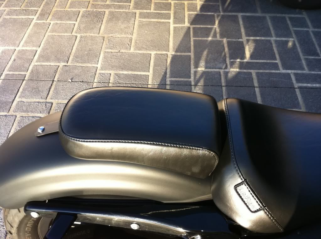

  • darkdesign
    darkdesign
    looks good, how's the paint gonna cope under the extension? just thinking if/when you take the pillion pad off, you'll have a rubbed spot.
  • terroristone
    terroristone
    i use a Toyota sump plug washer under there, they are fiber, seems to be holding up nice, no mark as of yet..
