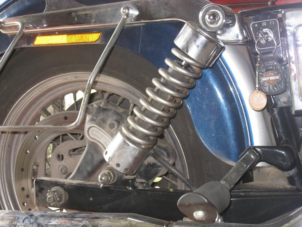

    Hi all,
    I jagged a cheap set of progressive 412 shocks for my iron, they only catch was they were the chrome ones.
    They will probably look ok on anyways because my bike isn't all blacked out etc but does anyone know of a good cost effective way of painting or covering the chrome black??

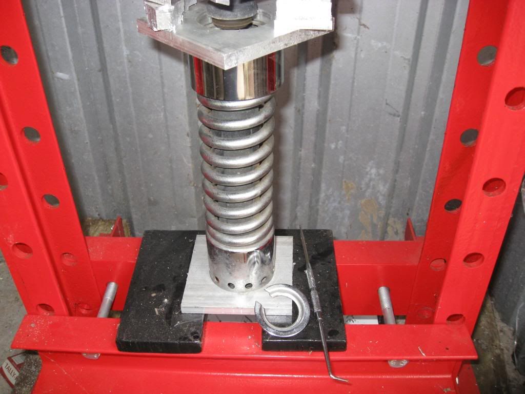

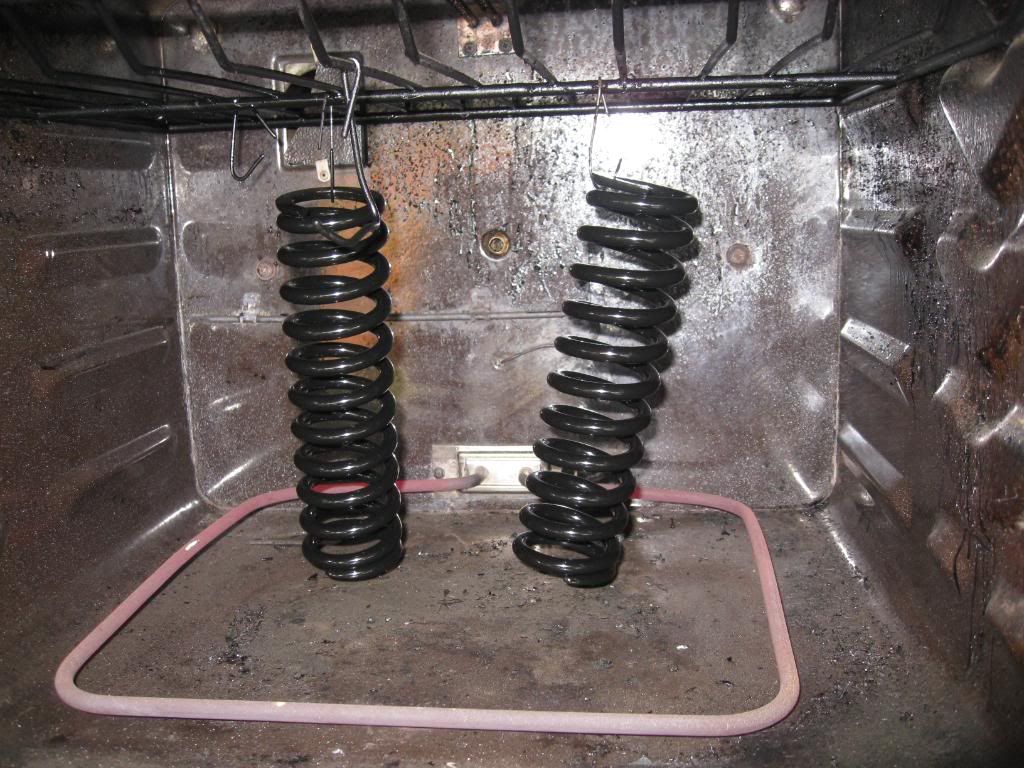

    Mrs Issues shockies getting the powdercoated springs above.
    My shocks at the end with powdercoated caps.
    Can't do for you myself at the moment Kookie but got a mate in Bundy that can.
    Send me a PM with contact phone if you're interested
