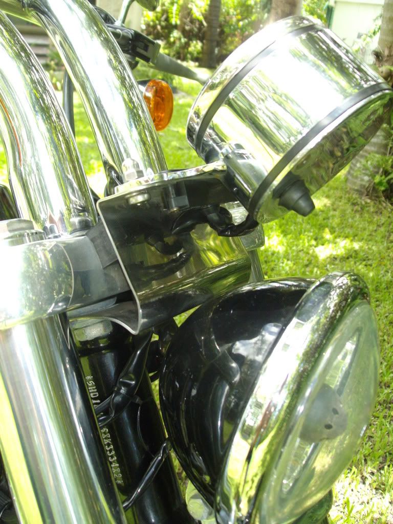

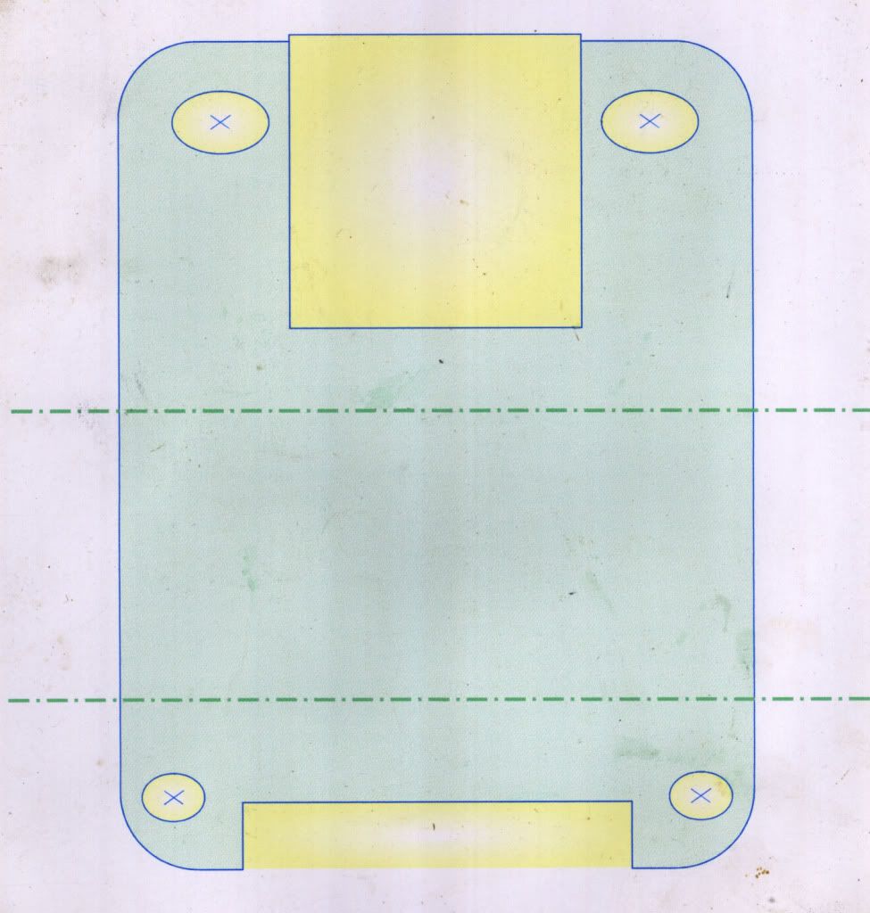

    As far as mounting the speedo .. I ended up getting a chrome mounting bracket.. From HD http://accessories.harley-davidson.com/product/sportster/gauges/chrome-speedometer/tachometer-bracket-kit although the one shown here is for Tacho and Speedo .. I got the single one.. as I don't have the Tacho equipped on my ride...
    ... and I needed then a bracket to mount the bracket .. lol, which I've made ... by cutting a piece of cardboard then bending it to get a profile.. from there I got some 2 mm stainless (would you belive from Bunnings) it was a stainless plate with a sign on it that said 'Grey water in Use' LMAO .. it was the perfect size.. and still on the shelf there... I'm still laughing.. I polished it up.. after bending and drilling it to my needs...
    Harley parts at Bunnings ..
    Below is the profile of the template I drew up in a small publishing program ...
    The picture shows how it is mounted .. I've since cut out a little more from the 2 mm stainless to allow the headlight to adjust up a bit higher...
