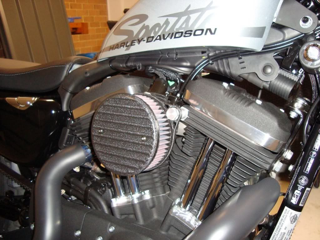

    I ended up going for the one from Figure Engineering. Heaps of cover plates to choose from but I wanted it to look simple so it's ribbed, wrinkle black on wrinkle black. Only part I don't like is the red from the k&n filter

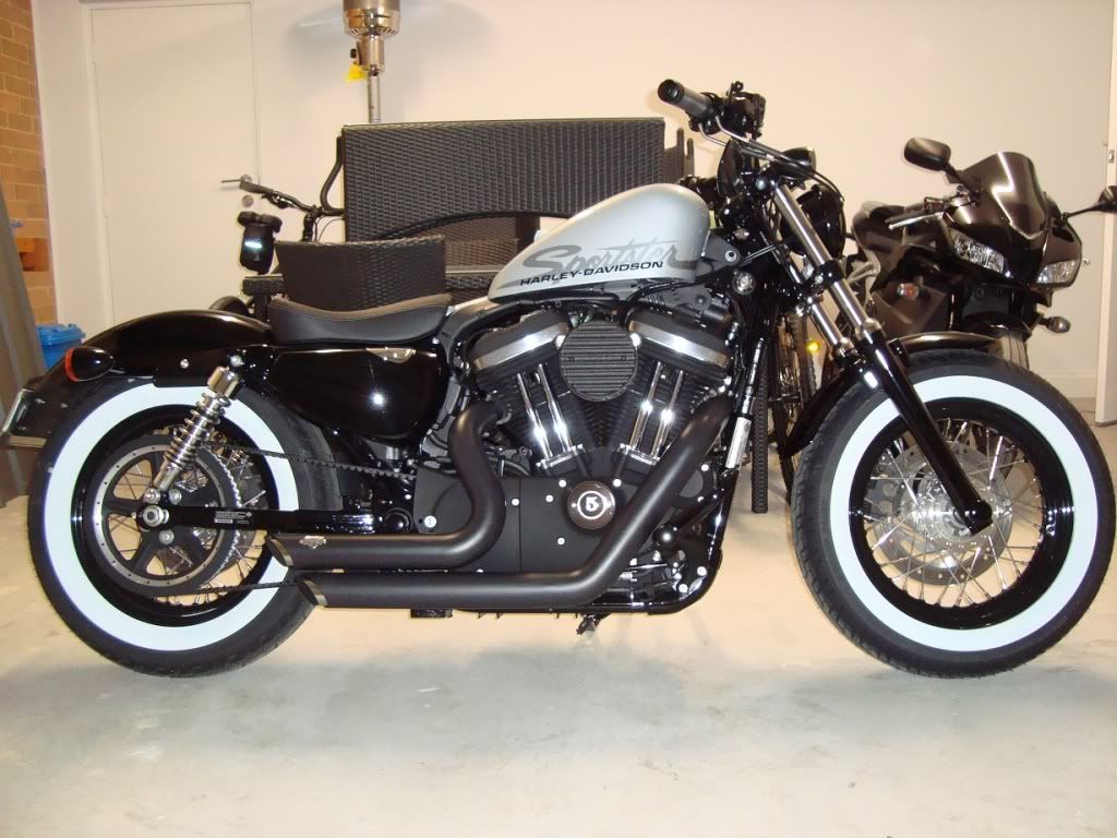

    While I was at it I removed the belt guards. Now the rear looks too high so I'll have to lower it an inch or so...

    Looks great.
    As for the red colour on the K&N filter it is the colour of oil which they spray on the filter to trap the dust and dirt. If you clean the aircleaner you will find that it is a sort of white colour without the oil on it. The Filter will go black eventually.
    But I wouldn't run it without the oil as it will tend to let a heap of dust into your engine.

    love the wrinkle black finish !!!

    Looks great without the belt guards, it would be nice to see how long before rocks fall on the belt then go through the pulleys making the belt snap.
    Even though it looks great it may be an expensive exersice.
