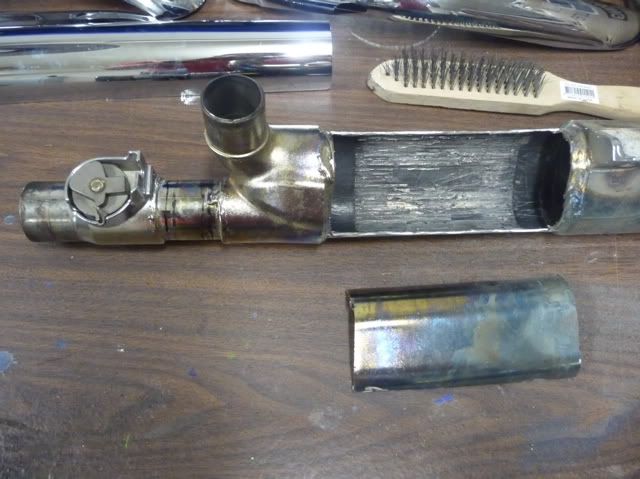

    Method of cut and shut was far simpler than I had originally thought out.  On the "Collector" before the cross over tube turn off, you cut out the inside panel, the inside of the collector area, with a small cut-off wheel on a small grinder with a thin metal cutting wheel..  It is a clean cut, that is easy peasy to TIG back neatly without distortion...

    OK-- let me get this right as it's a job I need to do and I have the welding skills to do it. SO-- you didn't cut the collector in two pieces; rather you cut a window into the collector and gouged out the cat shit then welded the window back in?
    If that's correct could you nominate what the dimensions of the window should be, and the measurement from the cross over turn to the start of the window? What did you use to gouge out the cat shit? Anything else I should know?

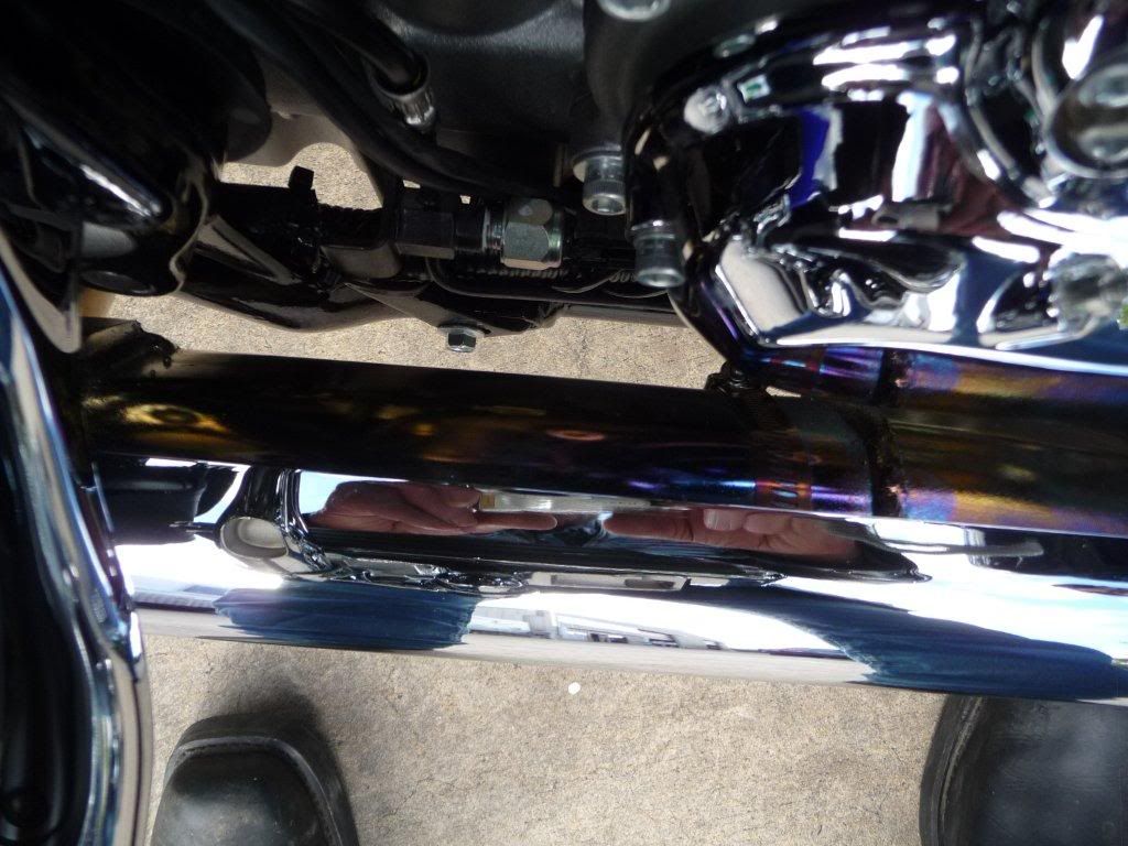

    Make sure yours is the same shape, this is off a 103 Street Glide.  It starts at the casting right behind the collector per this picture, which is the same as on my last Ultra as well.. As to the welding skills, TIG would be nice as it is stainless.....
    I can't give you the dimensions, as I have not had the chance to do it myself yet.  I had the idea, and was talking with a local Shop about the "Cut and Shut" to do on my own new scooter coming next month, and they took it further themselves and forwarded back these pictures.  But I had this same Header on my last Tourer, an Ultra, and it was identical.  From memory, now don't go on this for sure, but from memory it was the same on my Road King with the 96 c.i. as well.  I thought it might come in handy to some of you, especially since they Dynoed it before and after...

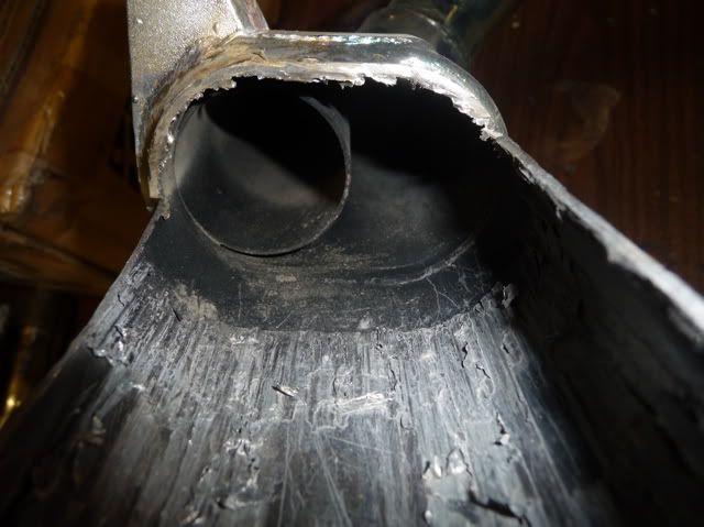

    Good one Cowboy!-- Big thanks for the pic. I can see they cut just in front of the weld and (it looks like) they went deeper on the bracket side. Without seeing the pic I wouldn't have made the cut so deep on that side. TIG is the best way to go for that work.Yep-- I can do that. You've made my day-- Cheers.
  • V2Evo96
    V2Evo96

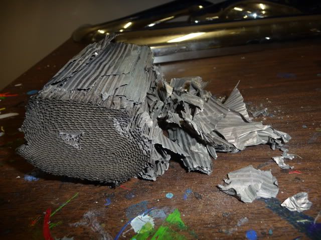

    Cowboy, I'm at home now and can see all the pics-- I looked your original post at work and I couldn't see the first set of pics as I'm blocked out, but I could see the additional pic you sent as my email tracking is on. Makes the rest of my posts look/read "stupid" LoL.
    Was reading elsewhere that the cut can be 5" long by 2.5-3" wide and is enough to get the catalyst out. Also if done from the outside of the collector the heat shield totally hides the weld-- could be a good thing to do as well.
    In the pic of the catalyst it looks like they dug into it from one side and rolled it out of the slot-- could be why the cutout is big.

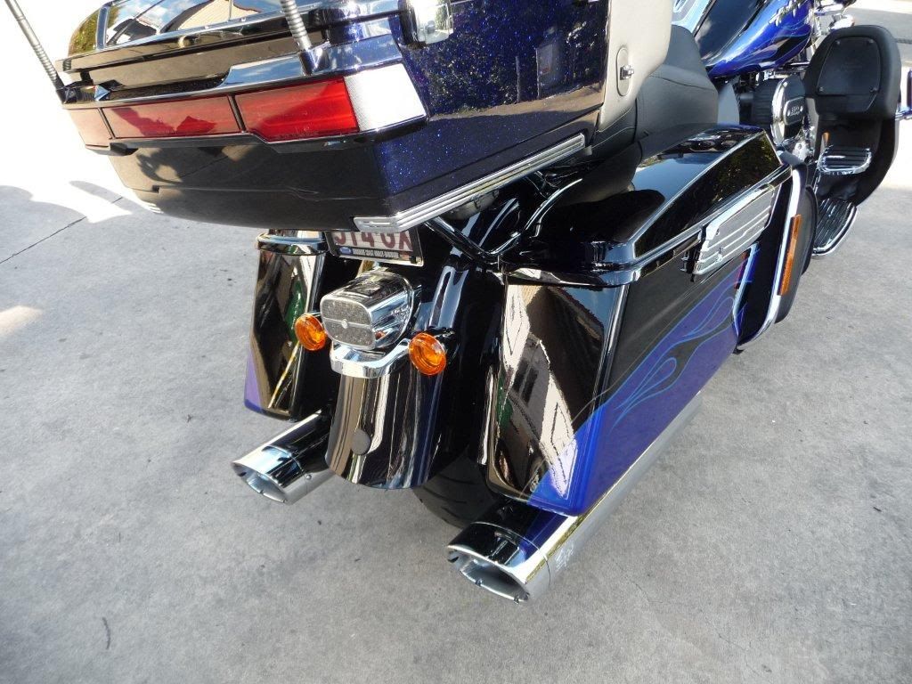

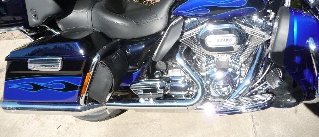

    Here is the latest engineering on my new Bike, same cut, BUT REVERSED ON THE OUTSIDE..   Kitty kicked out...  This way you cannot see the cut or weld up of the window, the outer heat sheild covers it...  Here is the picture of it done on mine, this is a first and everyone thinks the best so far.  The exhaust is not as muffled, a little clearer, and with the Monster Ovals on my new CVO Ultra, it is LOUD... But not too loud to be irritating, just a bit loud around town for "no blind spots.. heh he  Major improvement, still the extractor two into one cross over for exhausting the cleaning stroke cylinder...  And CHEAP to do...    Hope this latest idea is a help... In the picture you are looking down at it from the top and can see nothing... nuttin but cool...
