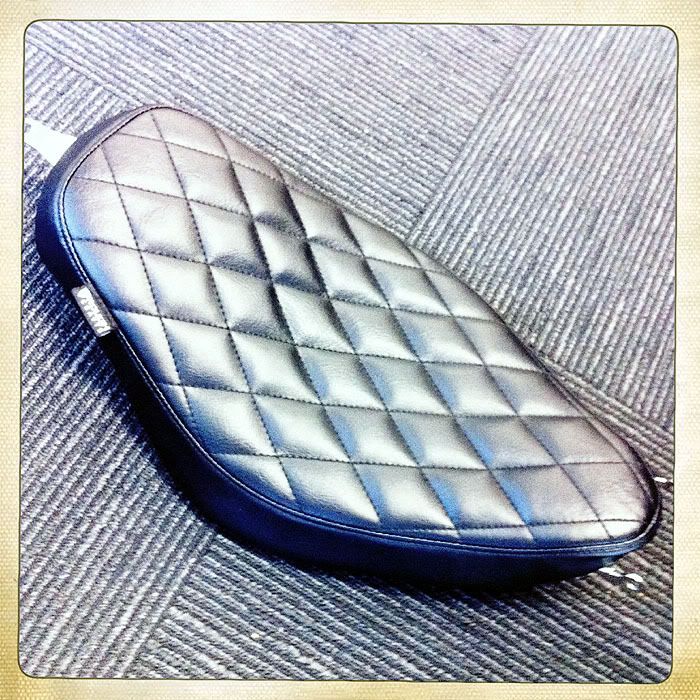

    The bike is nearly finished...
    Just walked through the door from Rough Crafts in Taipei, Taiwan
    http://roughcrafts.com/

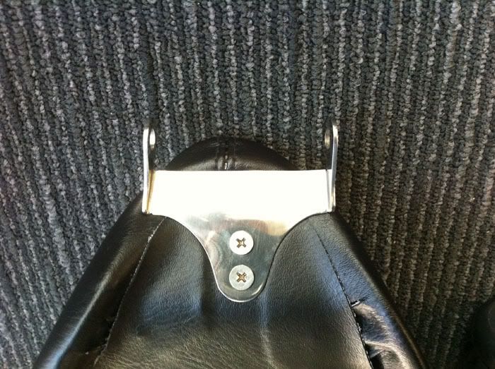

    Its beautifully made, carefully polished stainless brackets, stitching is perfect, seat pan is solid.. Only thing concerning me is two rivets holding the rear bracket, hoping they wont contact the rear guard
  • kookie
    kookie
    I think the two rivets are actually for the front mate, if you check out their website the bikes have their brand tag at the back so the two rivets would be at the front near the tank.
  • Mr.Mow
    Mr.Mow
    The bloody front bracket has been installed crooked and off centre.. it should fit as its a bit bendable but will sit off centre.
    I'm hoping I can get an undrilled bracket from him and drill it off centre to make it sit straight.

    haha ah yeah the rivets for the bracket...not the actual bracket..I getcha.

    Bugger it.. this is waaaaaay off..

    thats easy fixed, slot the holes, make a small plate with holes drilled to size, place plate over top, position bracket where needed then tighten screws, easy as, should be able to do that in 30mins depending on how many beers you need. if its something you are unable to do pm me and i'll fix it for you.

    Wasn't a huge drama in the end, the bracket was a little flexible, bent ever so slightly so it mounts pretty well. If you look at it top down closely you can see it's a bit off, but really in the whole scheme of things it's a non issue (I used to be the most picky anal bastard on the planet.. I must be getting old!)
    It looks completely PIMP! Will get some pics later.
    As for the rivets.. I cut an old rubber mouse pad and lined the back of the seat for insurance, stuck it on with dbl tape, should protect it well.
    It's a beautiful seat, hard though!!
    I have to say Winston got back to me very quickly and offered a full replacement, great support!

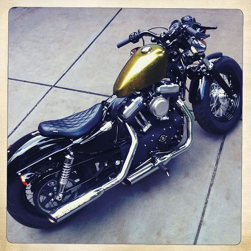

    Here we go.. pic of seat on bike..
    As for how it rides.. its hard, its very firm.. but its good, feels supportive, plants your butt a few inches back from the original, not sure I'd like to try it with forward controls, would be a bit of a stretch.
