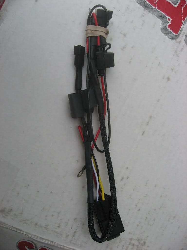

    Received my Shotgun shocks last week and just installed them.  Best bang for you buck air ride available IMO and they've made it so bloody easy to install.  Took some photos for anyone interested in upgrading to an air ride.

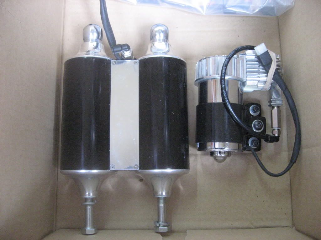

    Nice one piece unit and big compressor
    Simple harness with molex connectors and heat shrink ready to go

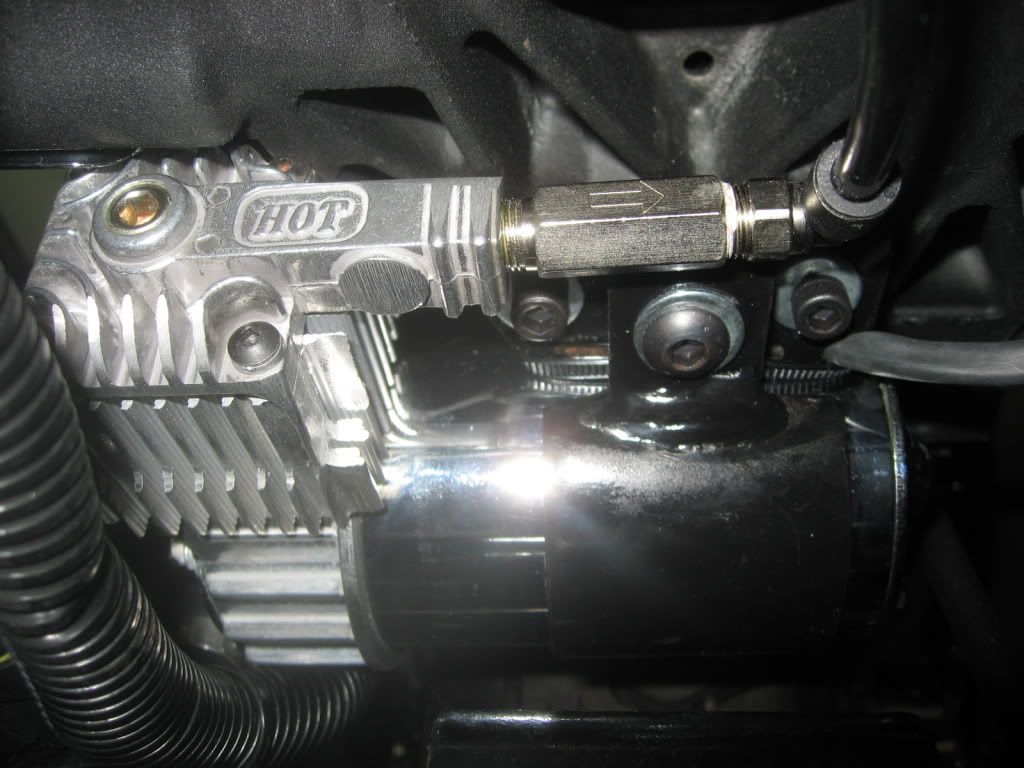

    Compressor with attached bracket just simply bolts under transmission with 2 bolts

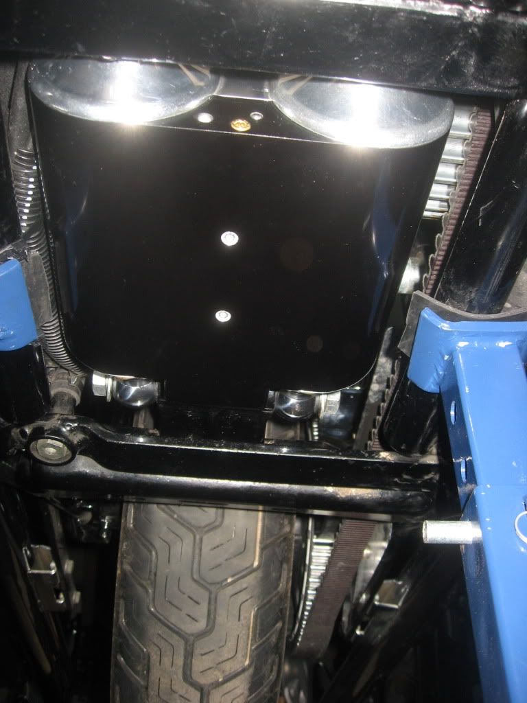

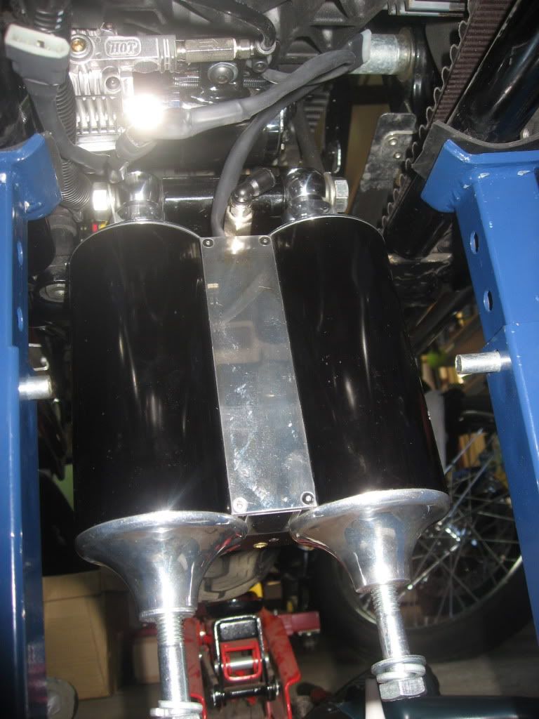

    Shocks are designed to drop down 90 degrees for transmission oil changes.
    Shocks installed

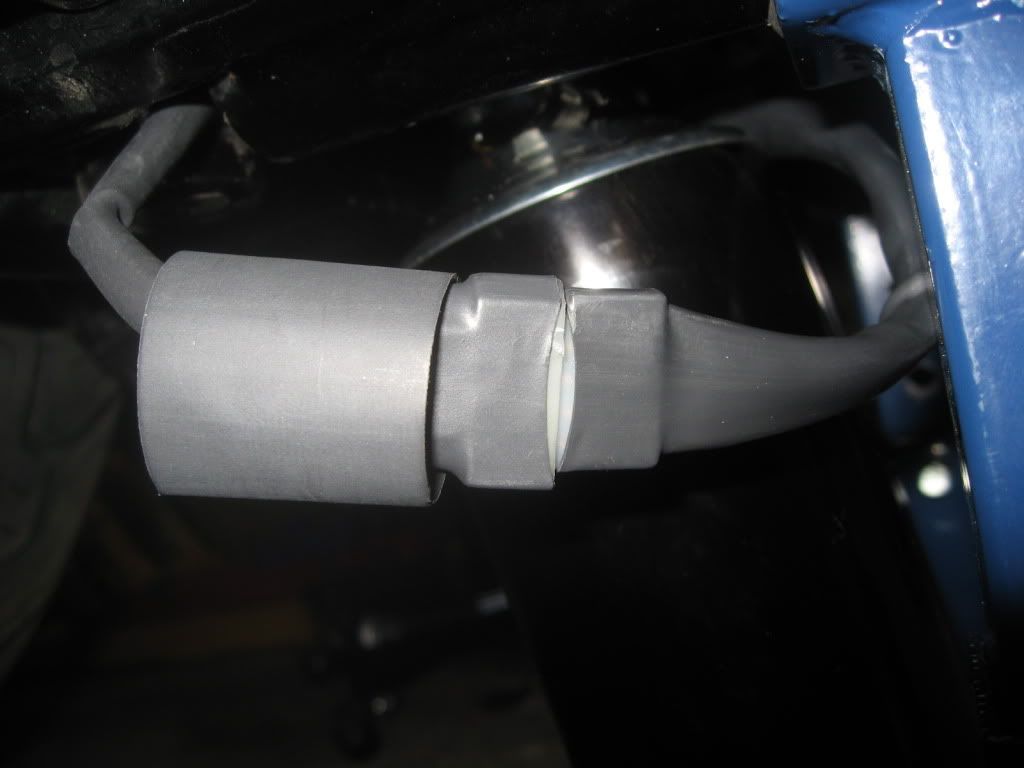

    Plug in one air line and connectors just plug in and shrink wrap over for complete seal.

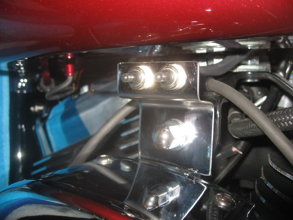

    Finally switch installed on horn bracket.
    Been raining heaps here so haven't had a chance to test the system out properly, but it does raise & drop the bike quite quickly.  Firmness can be adjusted to bouncy to almost stiff as a rigid.
