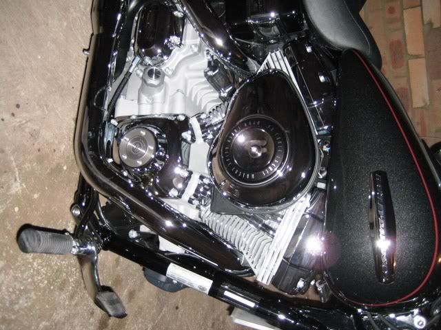

    Can't say re part #'s etc.. but... just swapped 08' Dyna superglide custom fm mid to front.
    They replaced with new parts - just thought you'd like some pics so here ya' go............>>
    other side is all capped & covered as per above
