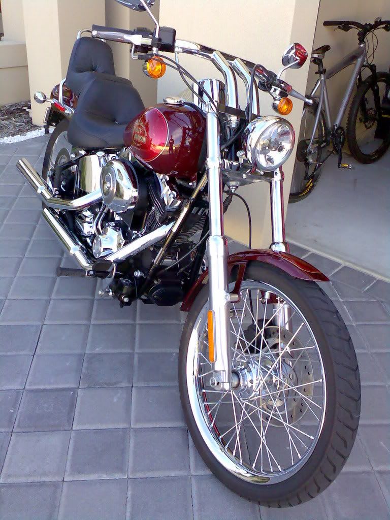

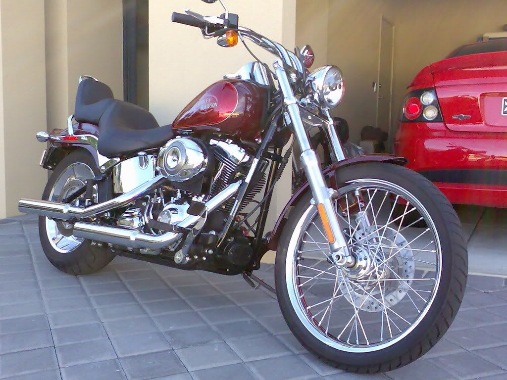

    Here's some pics of the burleigh T bar (8" riser) on my 08 custom. Couldn't wait to get my mini ape bars off and these on.  Great riding position and they look great too
    BTW: I still have the standard cables on from when the mini-ape bars were on and will be replacing them with braided lines soon.
