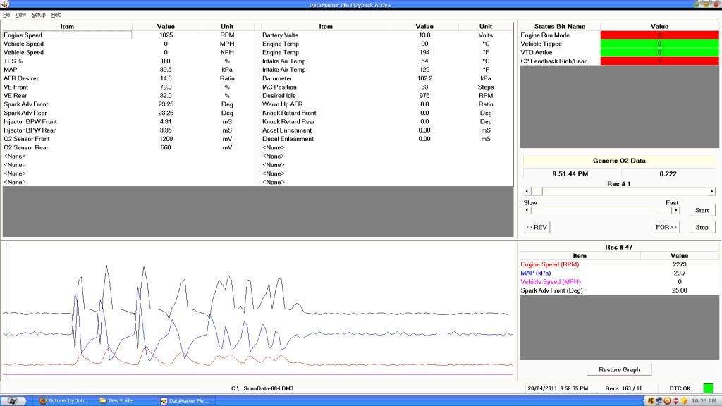

    I have just had the TTS running on my bike recording Generic O2 Data and I reckon my front sensor is stuffed.  It is stuck on 1200Mvs whereas the rear one fluctuating as per normal.  I have uploaded a couple of pic of the TTS Datamaster page.  I run 4 data runs and got the same result each time
    Thoughts?  They are only $50.00 each as I asked HH today through Luke.  Yeah I can get them cheaper in the US but waiting for 2 weeks is annoying to save 20 bucks per item.   So if someone has any ideas as to why the sensor is not fluctuating let me know.  I doubt if it can be cleaned.  I am going to do another run tomorrow on the way to work and see if there is any improvement, If not the of to HH after work.

    I will do that this afternoon. I just run the TTS on the way to work, and it is very sluggish in response. The problem seems to be more evident at idle. I just pulled the sensor as well to see if it was carbonized up and it looked fine. I will swap them over this afternoon and if need be replace both tomorrow.

    Swapped both sensors around and same issue, I had a look at the Map I am using and tweaked the AFR at idle from 13.00 to 13.9 and that seems to have resolved the issue atm. I will do another data run on the way home to check. If I am wrong to change the map let me know.
