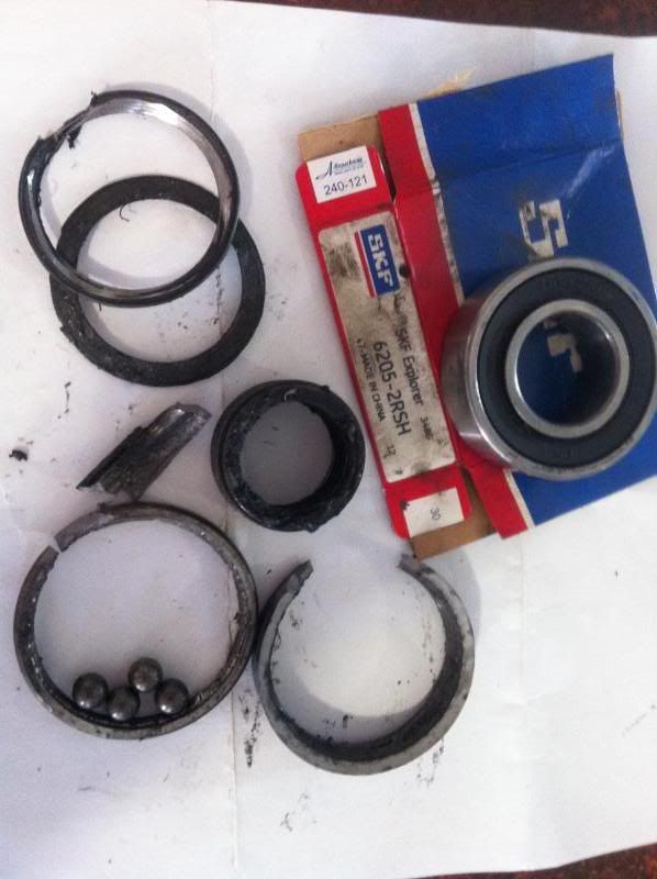

     Closer inspection reveals I do have a collapsed bearing.  At 12000kms.  A mate who worked in a harley shop once told me I should repack them as they don't do it properly at factory...and I thought he was just being paranoid.
  • r0880
    r0880
     Changed my rear bearings today was difficult getting the collapsed one out, bearing was all in pieces with only 4 balls left.  Other side was together but worn out and despite grease being visible, had a lot more resistance than the new SKF bearings I put in.

     Well I noticed on freeway that it felt like it was swaying.  After comparison with new bearings it must have been getting progressively worse, as it now changes gears smoother (felt like primary was a bit loose before, but it wasn't) and handles better than I can remember.  It never had any sideways movement when I tried to wiggle the wheel.  Looked like this couple days before I pulled it apart.
