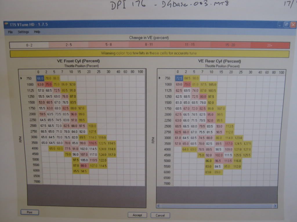

     After numerous vtunes and EGR adjustments, found I had to remove heaps of timing to try to eliminate knock, so much so that the bike started to run like shit! Realised that this was probably not the right calibration (DPI 176) for my build! so I gave up on it.
    Decided to do what I should have done in the 1st place.........try all the suitable calibrations in their canned state before deciding which one ran the best. As I did this I did sparkdata runs on each one as well, over the same short course for each one.
    All but one map showed a fair bit of knock. The map that showed no knock was DPS 176, which is a map suited to standard heads. Coincidently, I was running the MT7 version of this map with great results before fitting the new heads. I also compared how each cal felt while riding and the DPS felt smoother with more power than any of the other cals ....which were all for "performance heads". Seems odd as the VEs are probably furthest from my build compared the others!
    Anyway, DPS 176 it is...........the next thing I wanted to try was cam setting adjustment comparisons.

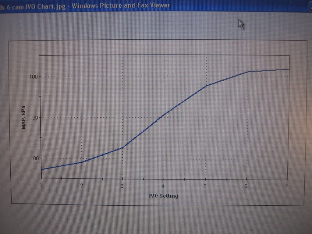

    The Camshaft Analyzer gave me an IVO of #2, which I am happy to stay with. The IVCs however cannot be determined without a dyno.........so I thought I would run the same cal with both IVC settings of #2 and #3 and compare the difference.
    There was not a real noticeable difference to be felt but the #2 seemed to run a little rougher and had a slight bit more "gurgle" on deceleration. I probably changed between the two about 4 times before I could tell them apart! Anyway, I have set it back to #3, which is where the estimator puts it for the woods 6.

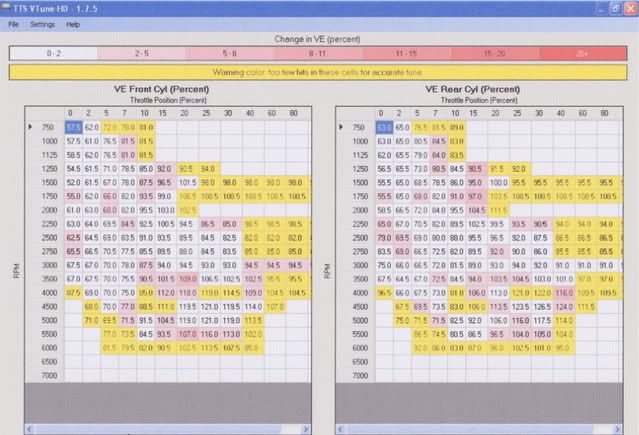

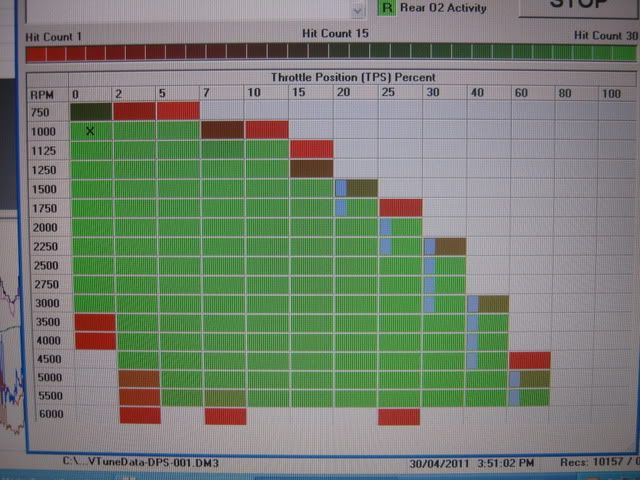

    Now for the 1st vtune run..........First thing I noticed was how much easier it was to get hits in a lot more cells than the other map, you can see from the histogram that I got a good range of green! I was able to get a lot more of the "lugging" areas without getting so many AFR faults.

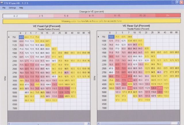

    Below is the 1st Vtune generated.........obviously a fair bit of change, no doubt due to the higher flowing heads. Will need to get a few more vtune dataruns in to bring the percentages down. I won't be worrying about the EGR tables this time round!

     Alright!! ........Had a win today!
    3 more vtunes on the DPS-176 cal and I have come up with this............
    I reckon one more run may remove a little more of the "pink" but I don't think it would be much. Due to the fact that I am "vtuned out" at the moment I am going to stick with this map for now!
    I loaded it in with only AKR set to zero and did a sparkdata run on the way home........rode it like I stole it, lugged it here and there, concentrated on areas that I got knock in before and whadaya Know...........NOT A SKERIC OF KNOCK! ..........Gotta be happy with that!

    Your 1st inflection point is #2, thats where you want to set your IVO. If you look at earlier posts in this thread, you can see a couple of us had similar graphs and wondered the same thing. Steve Cole set us straight on that one.

    I would have made it 3. The inflection isn't that great after 2

    The break point is 2. It doesn't matter how hard it breaks. Just that is does break. This is a good example of picking 2 and see how it is. KPA at idle and smoothness at idle. Then go to 3 and compare the two.
