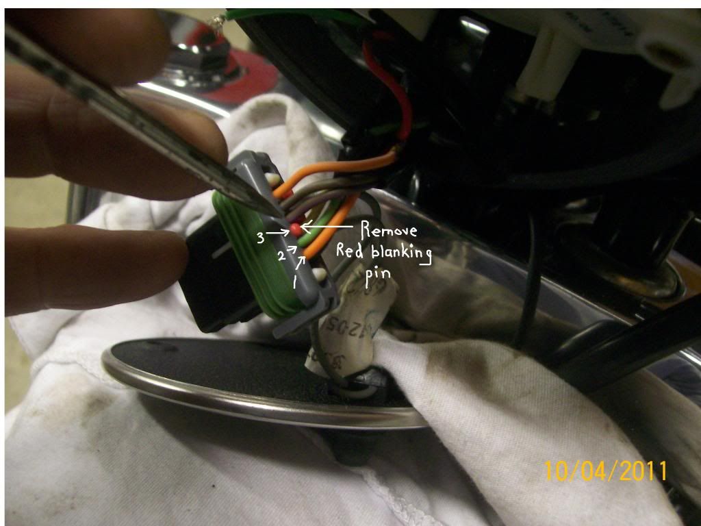

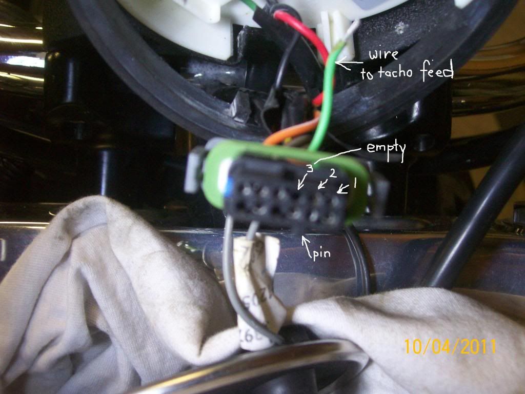

    Thanks guys .....harley instructions are shit to read or I am a dumb ass...this is what I found out and hope it makes it easier for the next bloke......cheers wingnut.

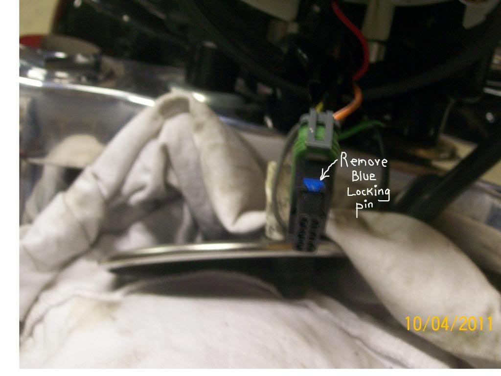

    Blue locking pin" />Remove blue locking pin
    Blanking pin" />Then remove red blanking pin

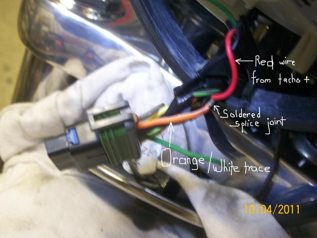

    Orange/white trace" />Orange / white trace to red tacho wire

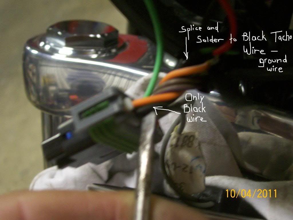

    Black wire" />Shit photo but shows only black wire to black to tacho wire
    Pickup to green tacho wire" />Does not show female Deutsch connection fitted.......Dick Smith not open on Sunday

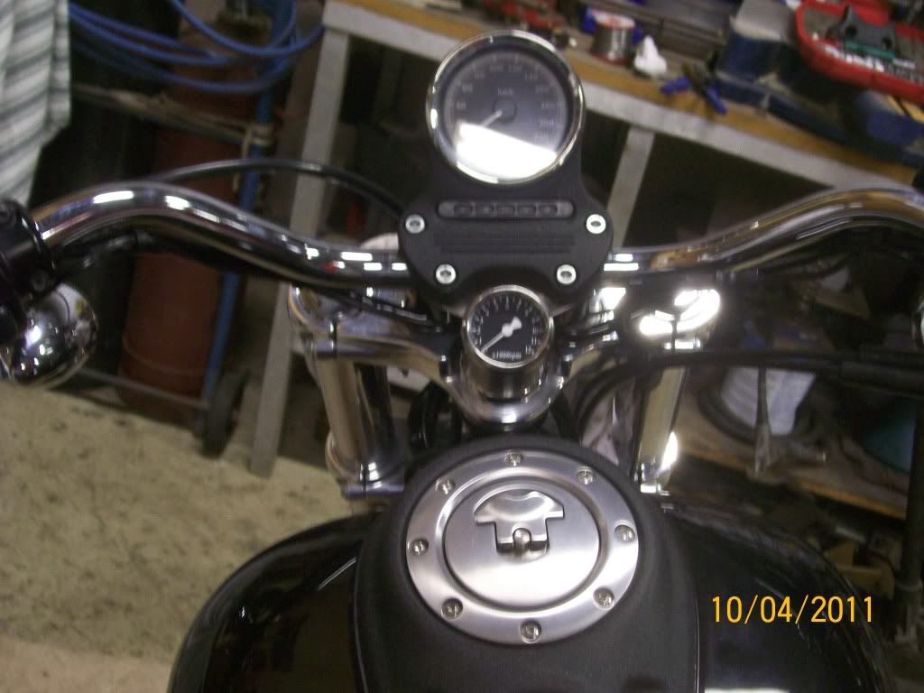

    Position of fitted tacho" /> Tacho position
    I will take another pic when I get the Deutch fitting and wire up the tacho light.......but it does work and yes it does read 12000 rpm the 8000 rpm tachos are no longer available in 48 mm.
