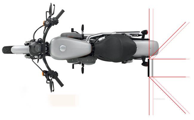

    Just reading through the ADR regs, Vicroad regs and looking at some photos of the factory holder.. it looks really line ball legal, the plate only has to be visible through a 90' (45 each side) arc, it really doesn't appear as though the rear tyre obstructs it all that much.

  • Mr.Mow
    Mr.Mow
    Geeze.. theres not much in it.. especially with the 2010-11 models having no tail light and chopped rear guards.
    This is the diagram from the ADR regs..
    Its a bit rough... but..

    nice work mr mow - very useful

    I bought my nightster with the side mount on it, no hassles yet. As Mr Mow shows above there's not much in it...

    I'm thinking if the plate can be smidged out to the left a bit, or a spacer put behind it.. could be completely legal. I don't doubt you'd still get a  defect notice for it though as I'm sure most cops would just see it as illegal, but at least you'd get out of it!

    Nice work with the diagram Mr Mow. The factory side mount bracket puts the number plate about one inch closer to the front of the bike than the dark black line in your diagram. It sits under the blinker/tail light, just in front of the lens. This means you would need to space the plate about four inches further rearward to be at the grey line in your diagram. This would ruin the look of it, I think.

    Yep I have an IRON 883 with factory side mount numberplate. you have to ensure you can read the numberplate from 60 foot back and 45 degrees either side of the bike in QLD. you can achive this by positioning the number plate about two inches away from the led light.
