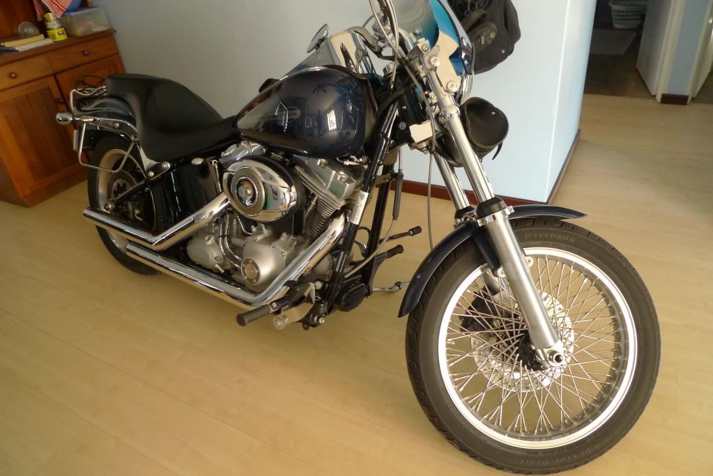

    Hi guys
    I have uploaded a photo, not the one that I wanted to paste, but it is better than nothing, I will provide a close up next week end when I am home.
    Cheers, Paul.

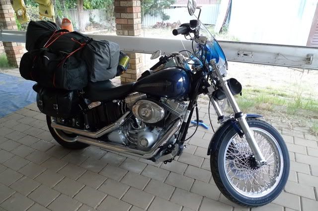

  • paulsails01
    paulsails01
  • paulsails01
    paulsails01
    the body bag is a comfortable warm swag, a must when tripping down the Eyre Peninsula SA. Apparently it is very hard to obtain alloy rims, remembering that my original criteria was to have a rust free set up, so the actual selection available to meet all the essential parameters is limited.

    Looks good...what's he charge to do the conversion???
  • paulsails01
    paulsails01
    My first reply is for Steamer, I can only relay information as it is provided to me, I believe that Mr Brian Morgan was quite honest when he informed me that what he quoted me was the best option for the sizes that I asked for, however Steamer I am under no illusion that over the last 6 or so months that there are other options available and there are even options that have not been sighted yet.
    Second reply is for Sparra, Mr Brian Morgan charged me $1300 cash which also included the new 19" x 3" tyre. I know that we can buy this item from the USA for about US$900 (without tyre) but as I explained I was happy to pay a bit extra for the advice and happy to keep the small bloke going within reason.
