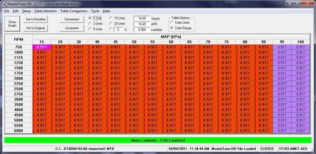

    Some questions about the latest TTS updates :-
    Finally getting around to starting my VTune runs.
    (2011 Road King, stock 103ci DBW, V&H Dresser Duals, Monster Ovals, SE Heavy Breather AC.)
    I may be a bit pedantic, but I some questions on the new MasterTune Tuning Guide revision 1.30 (March 29 2011) if anyone can assist ..
    1.       1. The new VTune flow chart 4.14 on page 72, – step  4A (Lambda) says “set all values that allow to 0.977”.
    Yet on page 53, section 4.3.1 (and Fig 4-3) of the tuning procedure says to set to 0.981.
    Which is correct, or does it matter as both are close loop.
    2. Also, my Cal file DTQ044-03-A0.MT8 has extra MAP columns than that shown in Fig 4-3 page 53.
    1.       3. Main Lambda, MAP 95 & 100 columns are set to 0.917 by the program during incrementing process, where as the Tuning Procedure Fig 4-3, page 54 shows 0.856.
    Should I be setting to 0.856, in lieu of 0.917 ?
    Does the “set all that allows” come into play here?
    2.       4. The new flow chart on page 72, step 4C says to set all values in the AE table to zero.
    Can’t find this instruction in the Tuning Procedure.
                                    PS : TTS, bloody good product, gets my vote.
