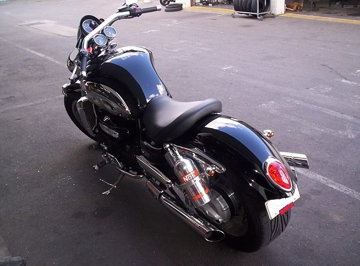

    Don't be put-off by the nay sayers about going darkside mate. I ran all 3 of my Triumph Rocket 111's with a 245 wide car tyre (run flat) and they handle fine WHEN YOU GET USED TO THEM.
    My wife and I also rode our Goldwing around Australia, towing a trailer, with 1 rear run flat car tyre fitted. Still looked new by the end of the trip.
    The problem you will face is getting a car tyre that will not rub on your belt. There are web sites dedicated to running darkside for more info.
    Plenty of grip on offer, including in the wet. Far superior braking on the rear as well. And if you decide to go darkside, you can use a run flat rear which you could ride aound Aus on with a puncture. Trust me, i checked the pressure on the rear of the leadwing and discovered it was empty at one stage of our trip.
    You do have to run them at lower pressures,
    Regards Lofty
  • jacks
    jacks
    Looks good Lofty
