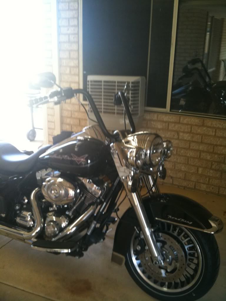

    Finally got around to fitting them. Thanks to Ando for the pics and tips in the workshop section.
    For the record - if you are going to do 12" apes you need to extend the wiring a good 6" and its a prick of a job. Clutch cable probably needs 4" but I got away with it for now re-routing it, I'll get an extended cable in a week or 2.  Brake line is untidy but plenty long enough.

    recomend over stock roadie bars? for me - yes. I'm about 5'8" and used to cop it between the shoulder blades. Only just put them on but going to do 1000km's + this weekend so will let you know how they go.
    I think lofty is probably a bit of a taller bloke than me (does "lofty" give that away?) but 14" was to tall for me.
    Ordered from M&M's for about $300 delivered, fitted myself (fiddly shit but not hard) should have extended clutch cable, and will, but you can get away with it if you re-route.
    If you don't want to buy extended wiring do it yourself - not hard and save about $50, or go through hillside custom cycles and get the whole kit for around $500 or $900 including controls (chrome master cylinder etc.)

    just did 1600kms with them over the weekend and a HUGE improvement over stock. only thing with me is anything over $1.30 and its like a big wind sock. Puts a bit of pressure on the hands being pulled against the bars.
    Have done something fitting them myself - the cruise control keeps dropping out now. Not sure if it's the larger grips bouncing the TBW sensor or my wiring...
