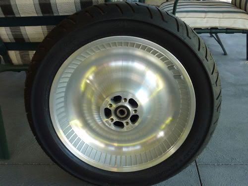

    I've just got on to a new take off 2004 Deuce wheel, that I intend to fit to my 2000 FXDX.
    Apparently they are meant to fit up easily, and the 160/70/17 tyre fits OK, as it's only 10mm or so wider than the 150/80/16 now fitted.
    Has anyone here done this, or know of anyone that has ? I think the solid disk rear with the spoke front will look good.

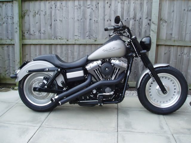

    This is about the only pic I can find of one fitted to a Dyna:

    Hey speedster, done this to my 08 Bob a while ago for all the same reasons u stated ,plus my original had huge amounts of rust on it, anyway i digress , in my opinion the bike does feel more sure footed pics can be seen on page 7 of show us ur dyna
    cheers Rags

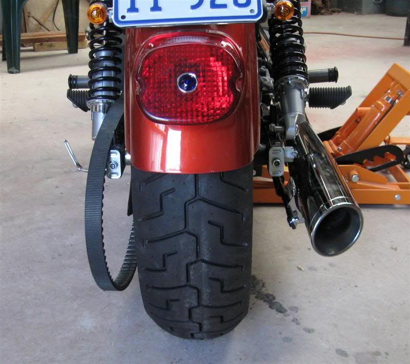

    Made a start today. Looks like it will be relatively easy.
    Now need to relocate the indicators. Gotta love the wider Tyre.

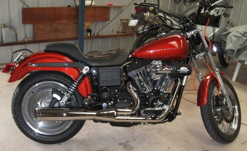

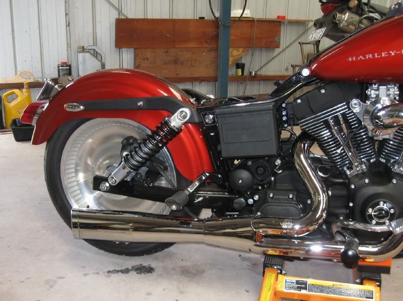

    Finished fitting the Deuce wheel today, and took the bike for a test run. A few issues fitting the caliper, but easily sorted.
    Had a new rear tyre fitted ( Michelin 160/70/17), that ended up being slightly narrower than the Dunlop, but has a rounder profile.
