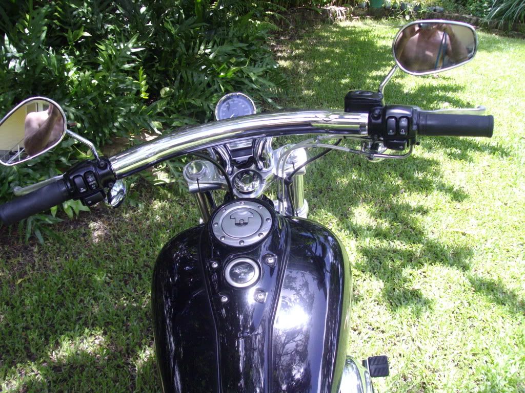

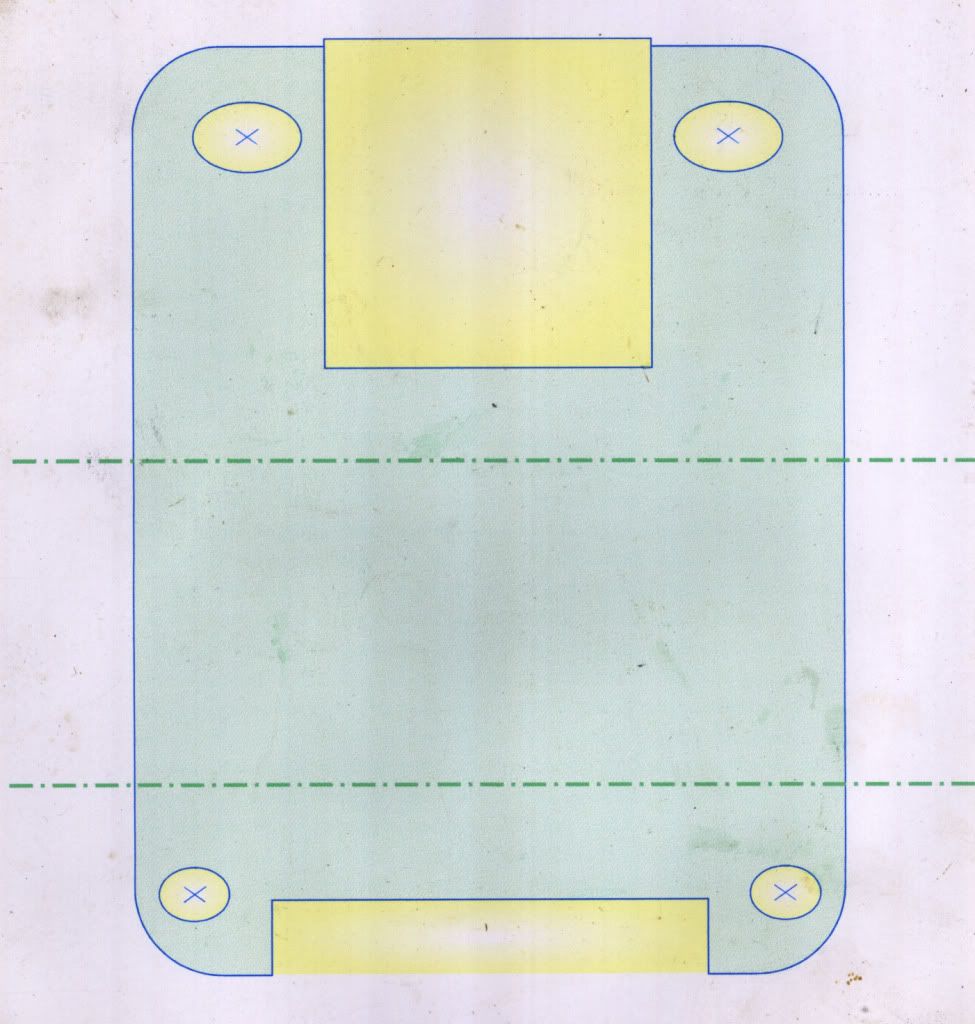

     Hi Gringo .. don't know if this is the sort of think you mean... but seems to be ? I've made a support bracket for the speedo. I have some drawings somewhere I can try to find, if your interested ... which I've drawn up as a guide..

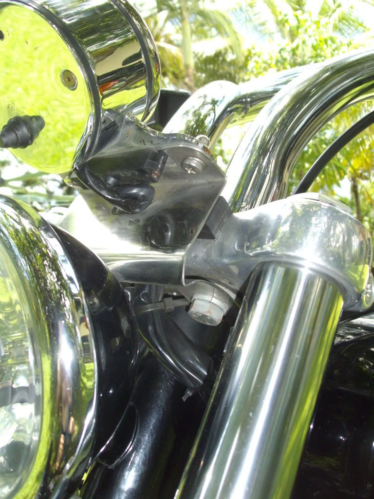

    I've also used the Genuine Chrome speedo bracket to house the speedo .. which replaced the crinkle black alloy one..
  • Noodle
    Noodle
    Under side view

    I made a bit of a design... and cut it out of a bit of cardboard folded it.. and adjusted as need be.. stuffed up the fold a bit.. but worked ok... I got a piece of 2mm thick stainless from Bunnings ... it was a small stainless plaque used to indicate 'bore water in use' or similar.. it was the perfect size for my needs.. I think there in virtually every store, it's a malleable stainless plate .. so will bend easy.

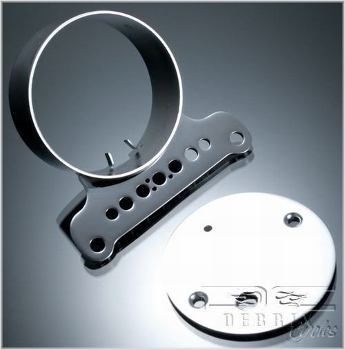

    Yeah .. ok was checking further.. on the 2006 model Dyna .. seems they sell this "Bling Thing" for the same item where discussing.. but can't find the specific housing in question dedicated to your model.. the housing is in the MULTIFIT section of my parts book...
    The main reason they wouldn't stipulate fitment I guess.. is due to it being a none specific 'Multifit' and the bolt holes would not align to anything on your bike.. unless.. making or designing your own bracket.. which I went about making out of a bit of Stainless.
    .. anyway for what it's worth.. a picture of the 'Bling Thing'.. not my cup'O'Tea .. but there showing it as 'Model specific' lol ... and the housing is EXACTLY same as I have housing my speedometer... with recesses for the indicator arrows, oil, neutral, etc... just to add to the confusion...
