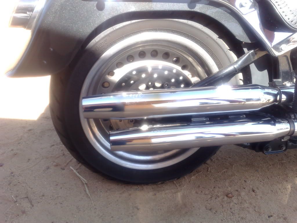

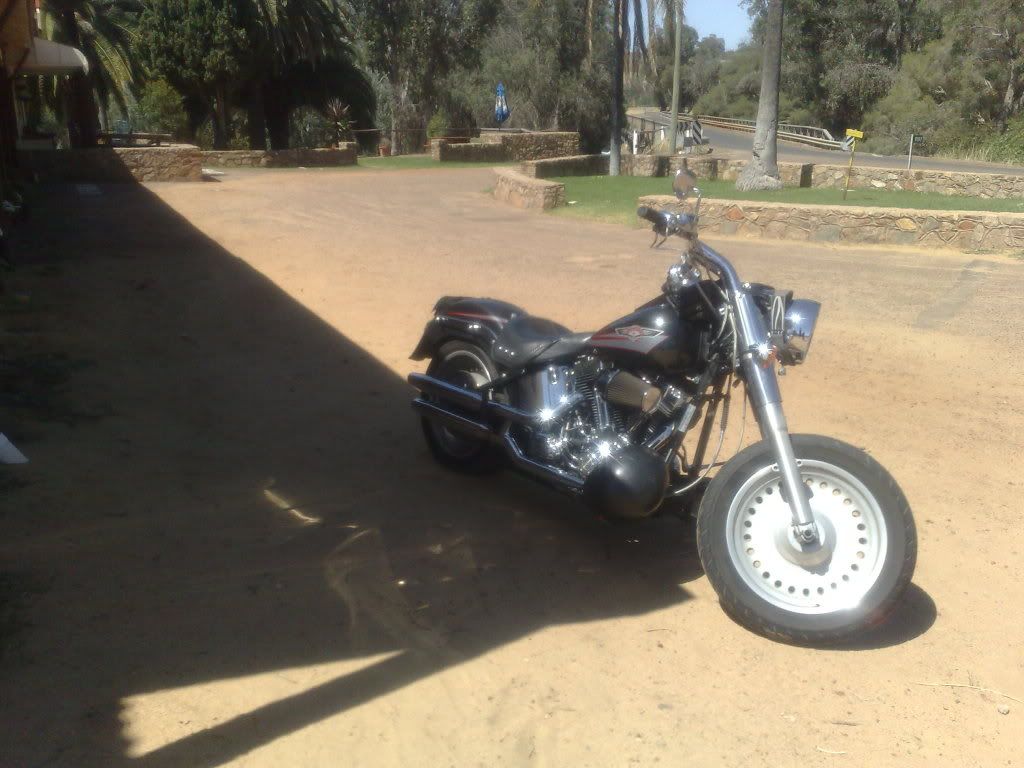

    Tire bungs and a can of foam air...bikers best friend
    had a blow out in the weekend gettin some practice in and rode 15ks to a place i new i could get help...fucken scarey shit but good practice
    wouldnt beleive but took my tire bungs out of my bag that morning and forgot to chuck em back in...WTF!!! got to a safe point and waited for a group of riders to roll up and asked for a tire bung sure enough they did (sprot bike riders too) and luck has it the pub had a air compressor...wicked
    Crasher
    P.S I was on the road at 5.30am so everything was closed every where i went  and every 1 was still in bed when i rocked up at this joint...lol
