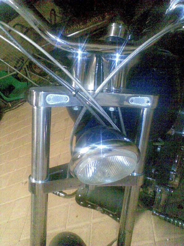

     Been doing a bit of searching on the site looking for answers about the minimum practical amount of trail . I put 2" over forks on my bike during the rebuild and it handles crap at low speed - its  a bastard to ride in a straight line .The bike is an '87 FXR and has a 26" overall diameter front wheel , 34" forks , 2" offset from stem to tubes , and a rake of 34 degrees measured with stock rear shocks whereas I normally run 11" shocks but the bike is currently configured for riding 2 up as me and the handbrake are about to head off to the southwest for a week
     I put all my specs into a trail calculator and it comes out at 6.5" which is way too much apparently. From what I have found on the web , you are looking for somewhere between 2 and 4 inches.I redid the calcs with 3 degree raked triple trees and it comes out at 4.4" so I did them again with 6 degree and its 2.35 " but then I have read not to go more than 3 degrees with this modificatoin or handling will suffer - is this purely due to not enough trail or are there other issues involved that my tiny brain cant fathom ?
