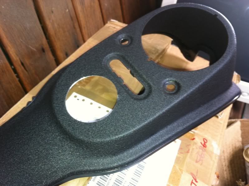

    drilled console with 2" holesaw

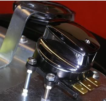

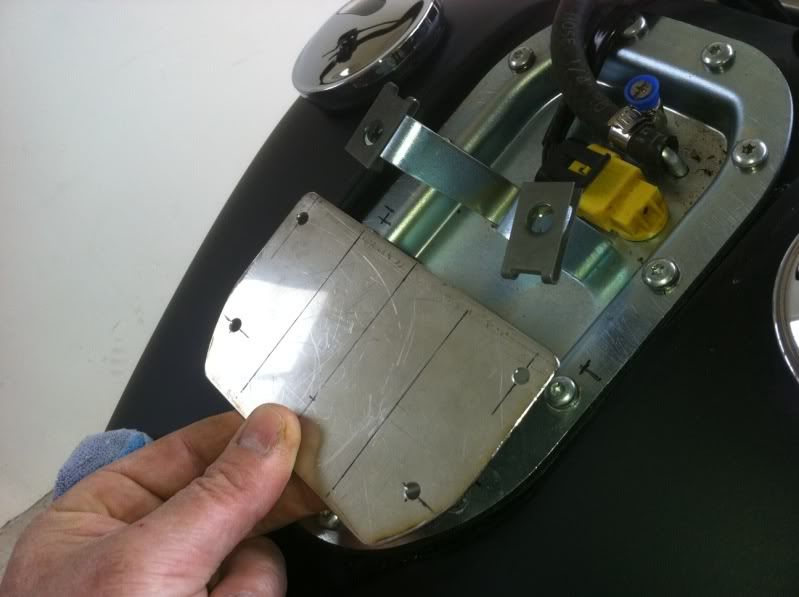

    Made up mounting plate for new switch
    Switch Mounted, this was just a mock up, screws/nuts have lock nuts and blue loctite

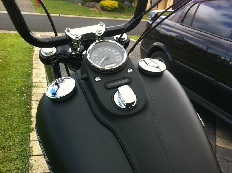

    Finished job - made the switch surround trim from some black wire insulation and glued it in place underneath the console

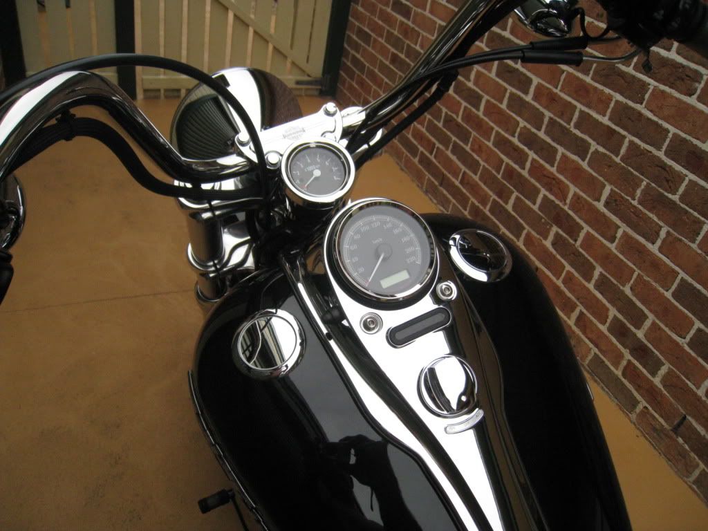

  • shfunky
    shfunky
    Looks good Daggs, I was going this route with my switch relocation, went as far as buying the rubber grommet to fit the hole (actually bought a few jic),  in the end with the dollar being so good and Zanotti's great prices went with the SE console, also saw Vladt's which swayed me,both ways look good imo, I like the chrome but also like the black original.  By the way, nice looking bob mate.
    If anyone doing this mod would like one of the rubber grommets to try just let me know and I will post you one free of charge.
    Here's mine.

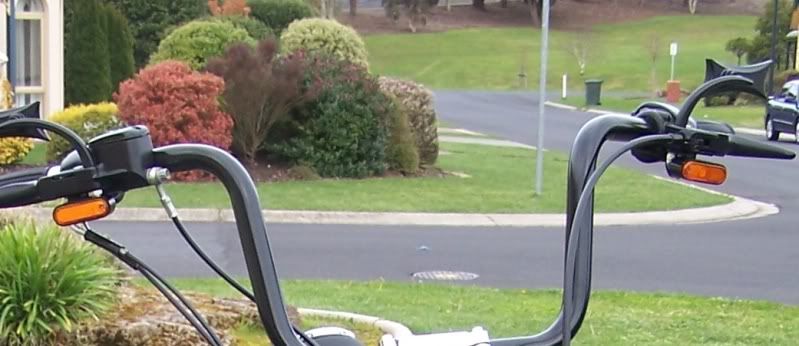

    Top mod Daggs. What blinkers are you using?

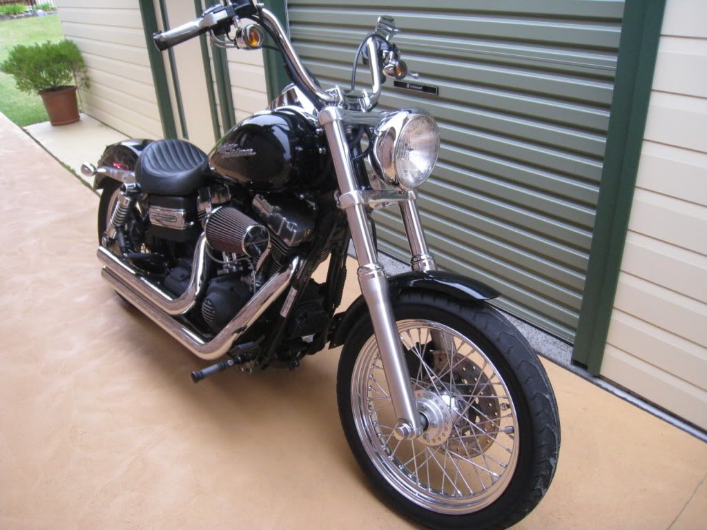

    the chrome looks shit hot on your bike shfunky, but the black console is better suited to the denim colours.... had considered the SE console for mine but it would look crap with Pewter Denim...

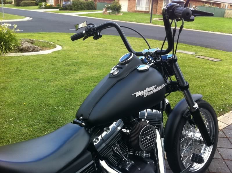

    don't have a profile pic ofmine but here is a side view....

    Train,
    The indicators are just something, I again, bought off ebay. These were unbranded but I think Zodiac have them, I'll try to find a link...
    They were chrome but I rubbed them back and hit them with some satin black epoxy at the same time that I did my fork sliders and levers and fitted the FatBob Black triple trees to get the wider front end.
    Looking at Ho's picture, he has the same (or similar) ones but still in the chrome.
    They are good as they are quite low profile and can bolt up easily to the existing indicator mounts :) heres a pic  not the best but you'll get the idea
