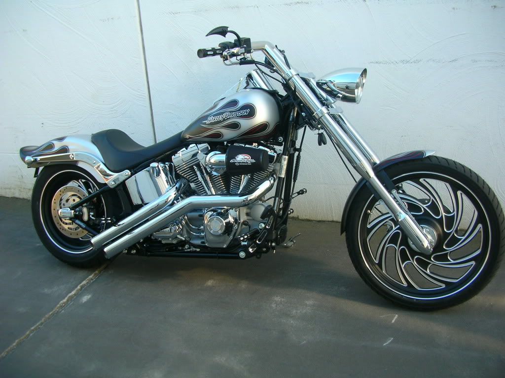

    Your 100% right Daggs.. This is a 2010 Soft Tail with 5 deg +2" over Legs

    Walka,
    That bike is a glamor.
    23in front wheel ?
    Im assuming a customers bike ?
    Any feedback about handling ?

    Every 3 Deg you need to Add 1" to the Leg. The Problem is that Replacment Legs or Tubes are only avalable in 2'" Lenghts. So with 3 Deg Stock Lenght is Fine . 5 Deg use +2" 7 Deg Use +4
    Based on Standard Soft Tail 32 Deg Neck Frame and Standard Lenght Forks 24" Long from under the Bottom Tripple Tree to the Centre of the Axle
