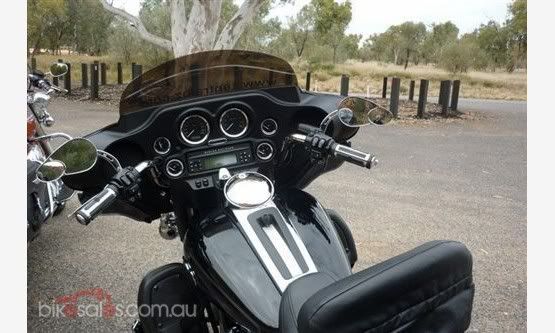

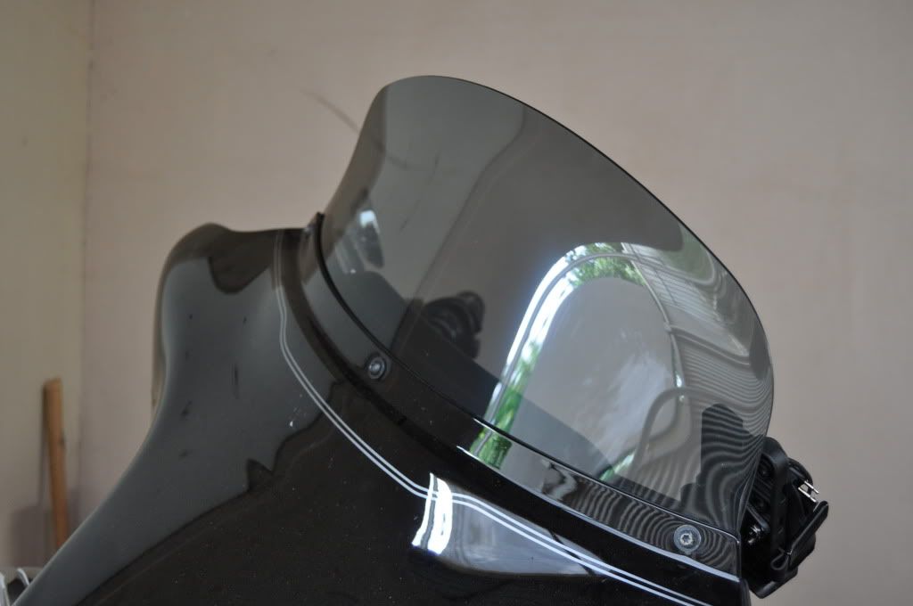

    Hi all, sorry to have been a bit tardy but I have fitted the new screen and in amongst the rain we have been having here in Alice Springs, I've managed to road test it on the highway. To revisit my story I have a 2008 HD Ultra Classic which had an aftermarket 6" dark tinted screen which you can see in the photo below.

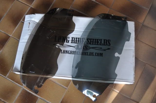

    The previous owner who was a bit shorter than me seemed to have no problem with the previous screen but me being a few inches taller found that I had buffeting at cruising speed. It was pretty annoying and so I started looking at different options. I looked at the Windvest, Eagle and the National Cycle V Stream before I came across the Long Ride Shield.
    So after a bit or research on sizes and types I settled on an 8" Ultra with a mid tint. The screen top is about level with my mouth and the idea is that the curl on the screen should deflect oncoming air up and over your head. You can see the two different screens in the photo below and although there is not a huge amount of difference, about 2", I am happy with the improvement and sure as hell I don't want to look through a taller screen!!
    The final product fitted (below) was worth the $90 delivered price (on special at the time) from the States and it looks nice on the bike. I know that this type of thing is a bit to do with personal choice but I thought I'd give you my appraisal on a change that I believe for me at least has been a move forward.

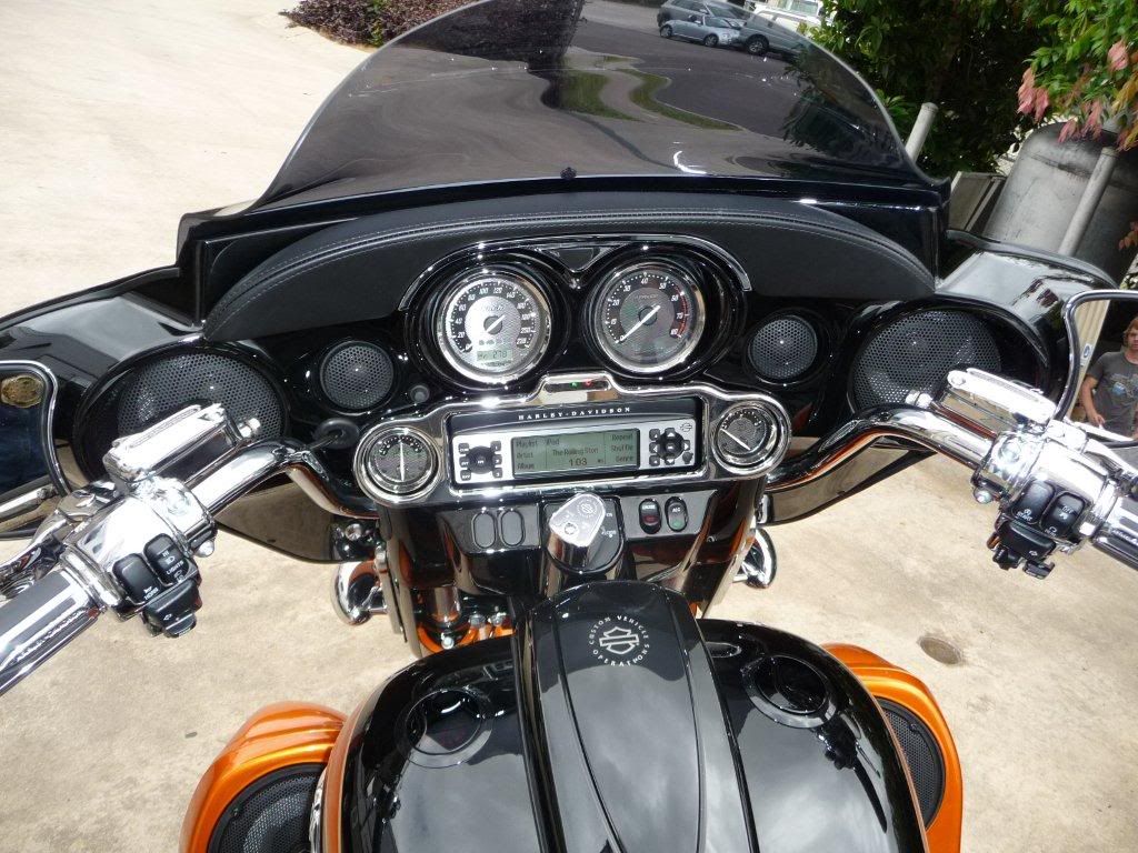

    I have had tall screens, that I don't like in the rain as double drops on my Full Face helmet screen and the big screen on the bike combined is too distracting.  It makes you want to put on windscreen wipers...   I have had about four different screens on Road King and Ultra, and the best was about a 6" dark tint from HD, no buffeting.  It was that shortie like AussieRanger shows, dark tint, and you hunker down behind it or look over... It looks cool and does the job to have.. or to have not...  Get one that is about level with just about your nose when sitting relaxed for your height.  Then you can sit up straight for more air or hunker down to get out of the wet.. You can have them cut down by a Professional for about $25, taped off, jig sawed fine over the tape, then sanded and polished edge.
    My new discovery here is the best of the best, as it centers the bike to go hands free, less buffeting, and for me at 6'1" I have to sit straight to get the wind or rain in the face, or relax and hide behind it...  Here shown on my  2011 CVO Street Glide.  I would have this again, and will do so on my 2011.5 BIG BLUE coming in July... Not only no buffeting, but it seems to hold the bike more true on a straight line.
