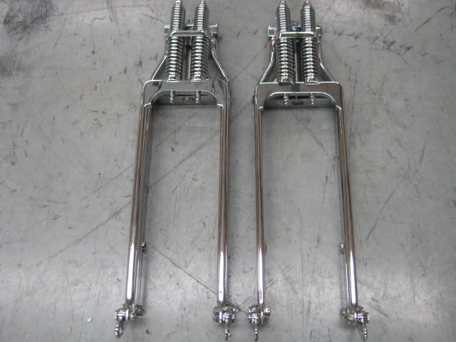

    Hey Uncle, what springers do FRC bolt on?
    There is nothing wrong with the cheaper Springers, You just have to be careful of what brand you buy as there not all the same.

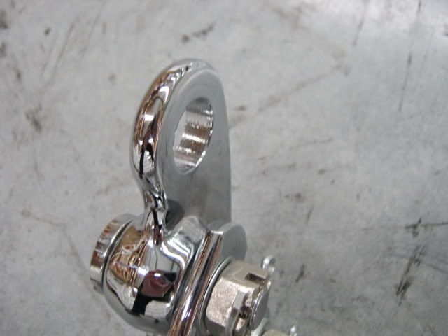

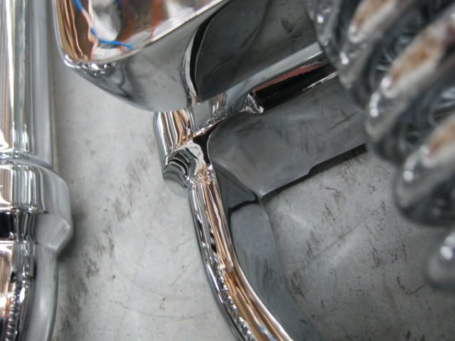

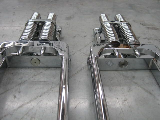

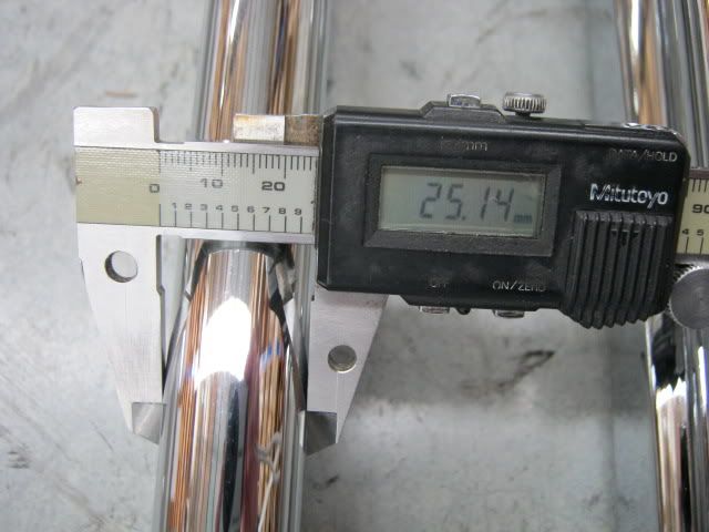

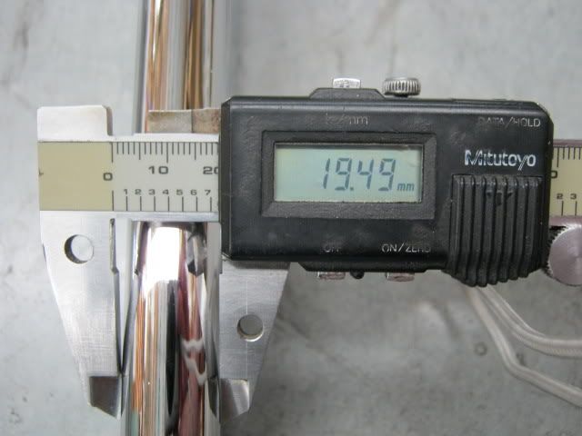

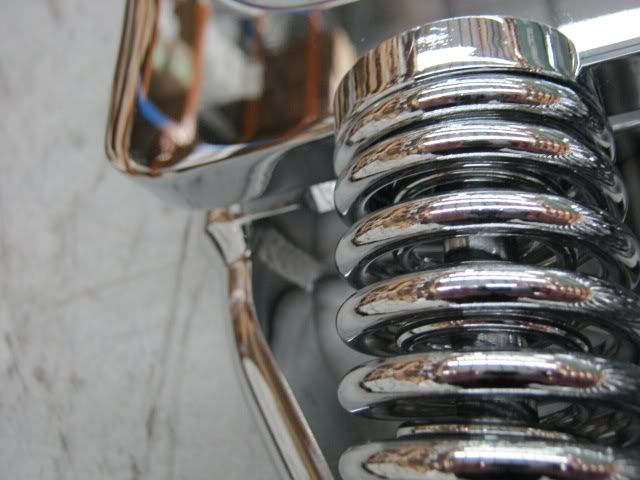

    Over the last year or so we have been working with one of the Asian Manufactures redesigning and inproving the good old cheap Springer. We changed the Internal Bushing, The Thickness of the Hoop Bar and Rockers, I also did some work with the Finish of the Welds and the Chrome. The End result is the Photos below,
    On the Left is our Attitude Inc Springer The Right is a DNA

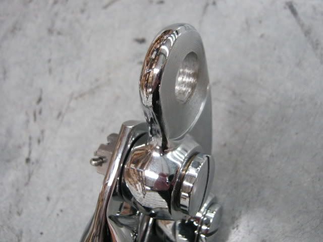

    DNA Rocker
    Thicker Attitude Inc Rocker
    DNA Hoop
    Thicker and Stronger Attitude Inc Hoop
    DNA Finish
    Attitude's Cleaner Finish
